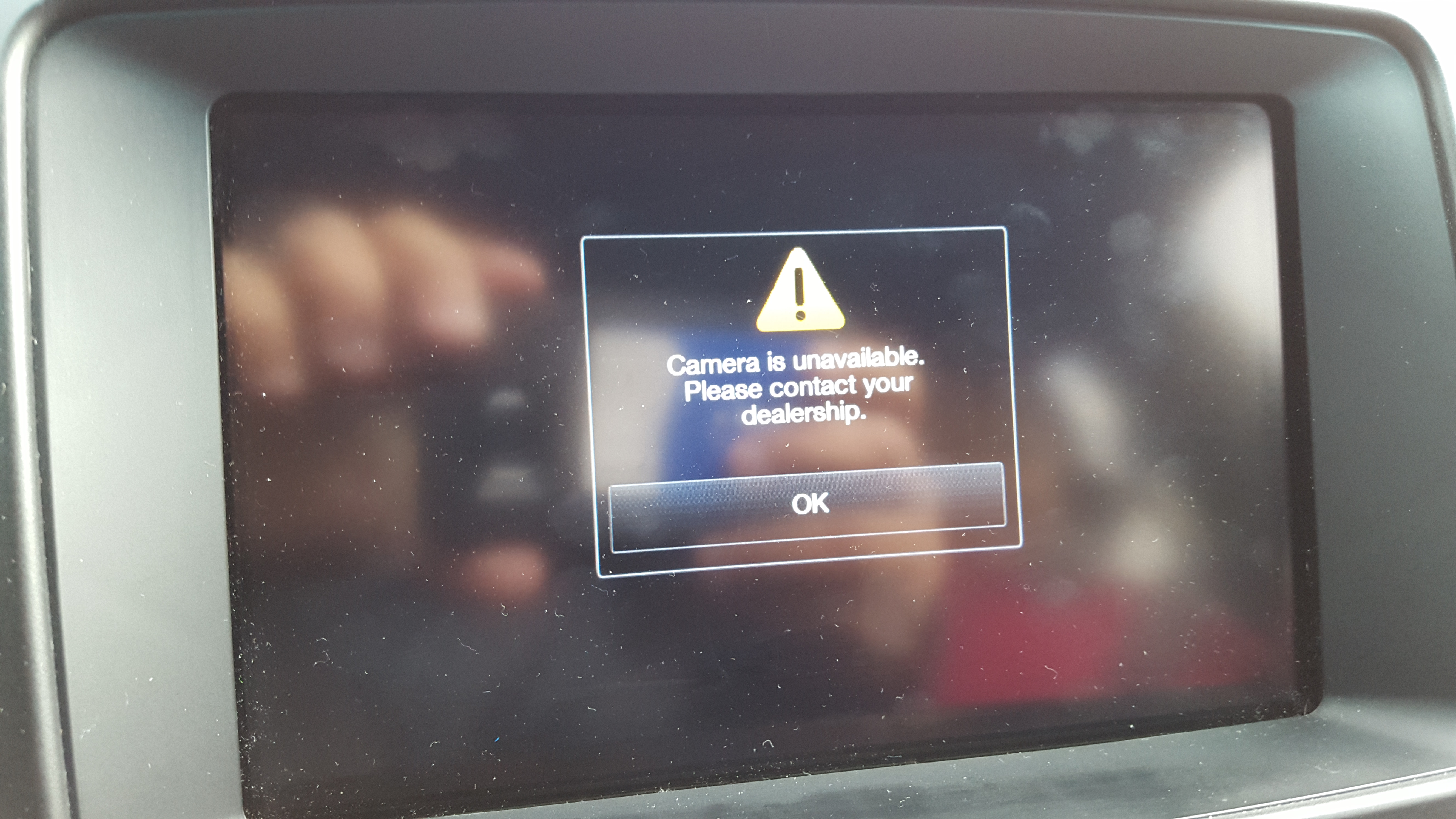

I am having the same issue with camera unavailable in my 2012 Limited. I took out the camera just to see if wiring was an issue and hoping that might solve the issue but no luck. I haven't tried the fuse yet but will tonight but given this thread, it is likely the camera module as many are failing around this time. My dealer wants over $650 for this part which probably costs $20 to make and a few short years ago was much cheaper. I am looking online, the part itself shows the part no. as BB5T-19G490-AE but places on ebay show that BB5Z-19G490-A is compatible. Is this the case and are there any others or aftermarket cams available or part numbers people have had success with? I am in Canada if that helps.
