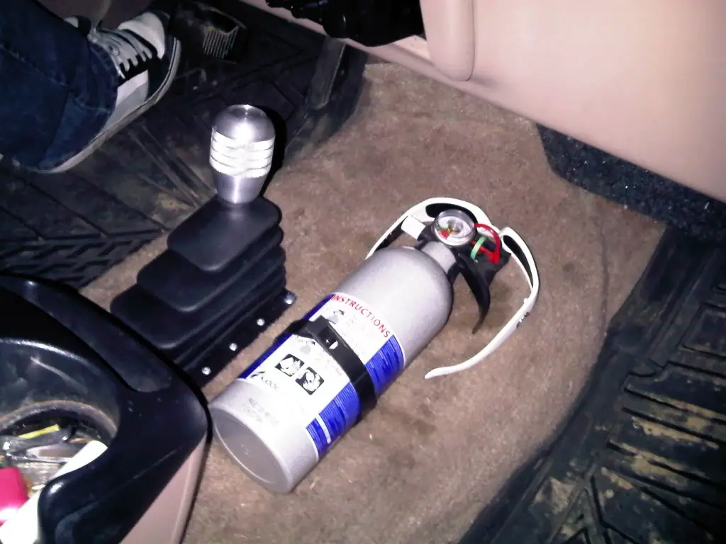

got the T case in and wired into the dash lights. looks OEM when in 4x4 or low range.:thumbsup:
than made the shift knob on a lathe out of some aluminum. debating if i should bed line that too...

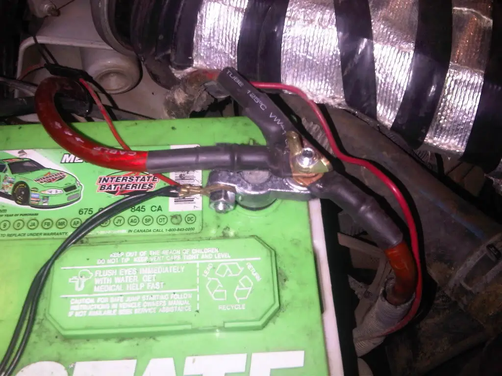

made my battery area cleaner with new terminals and soldered on connectors to all big wires

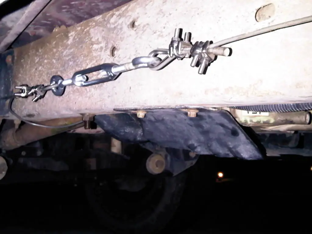

and fixed my emergency break cable problem.

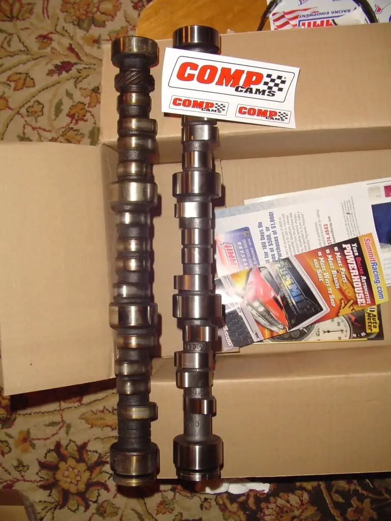

x Comp cam 410 lift
x smith bros 5.550 pushrods

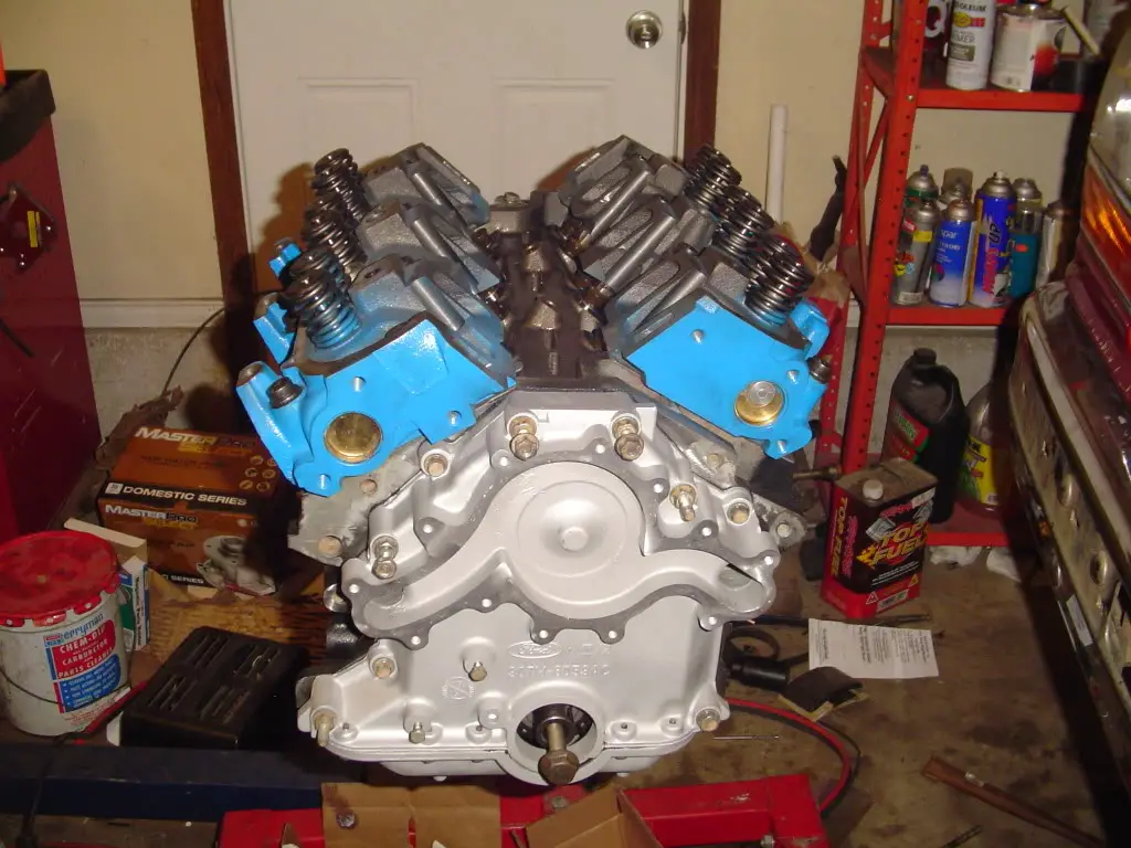

more progress to be made....got more parts for a hell of a deal.
182 in all.
felpro full upper gasket set
felpro lower gasket set
felpro timing cover set
national rear main seal
master pro water pump
more parts:
new (not reman) heads/valves/springs $515
Keith Black 50 over aluminum pistons $165
sealed power rings $73
only problem is that the Keith Black pistons and SP rings wont be in till august 8th...apparently 50 over pistons for a 4.0 arnt too popular:p:

all thats left is the cam, pushrods and headers.

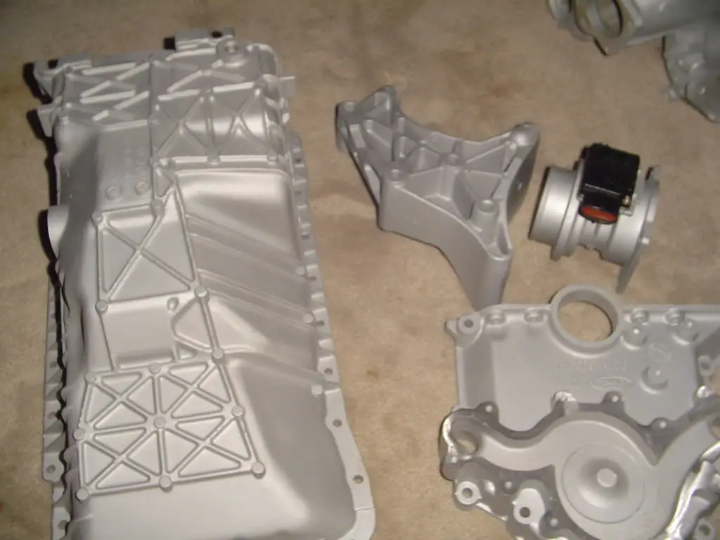

few little things ive done while waiting for my block at the machine shop...
(in this order) pillar pod is now finished, dash vent was replaced for an oil pressure gauge and i found more toys at the salvage yard.

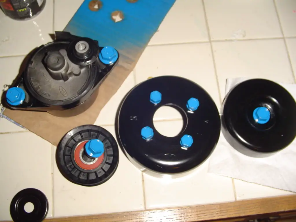

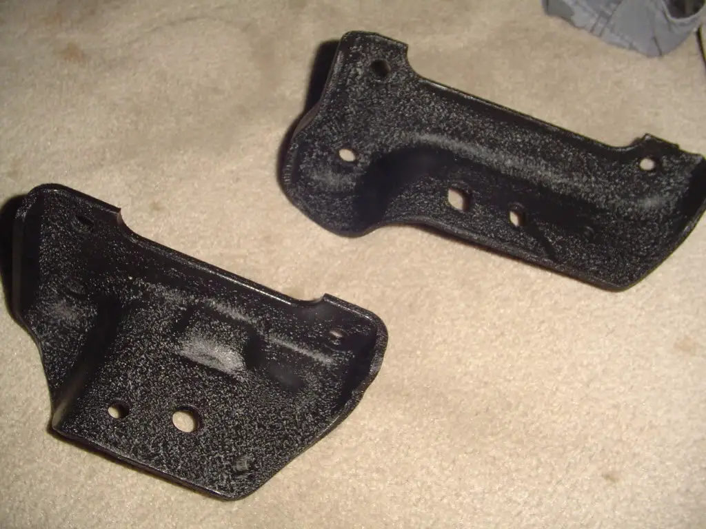

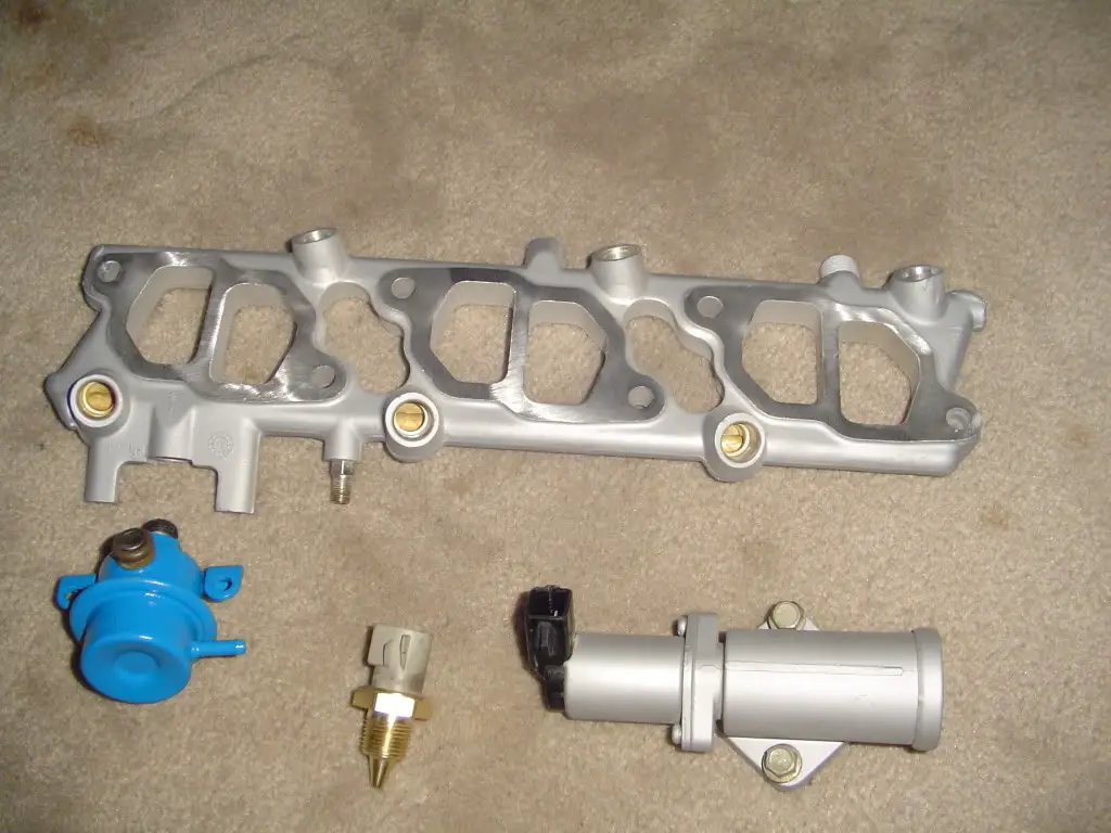

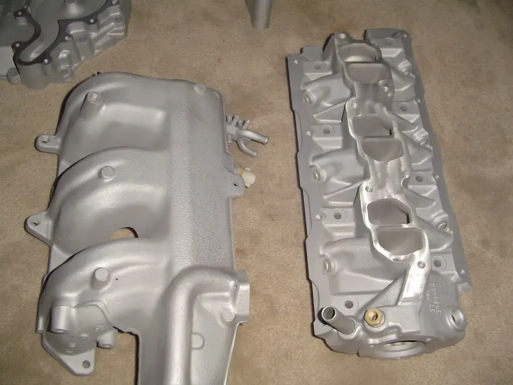

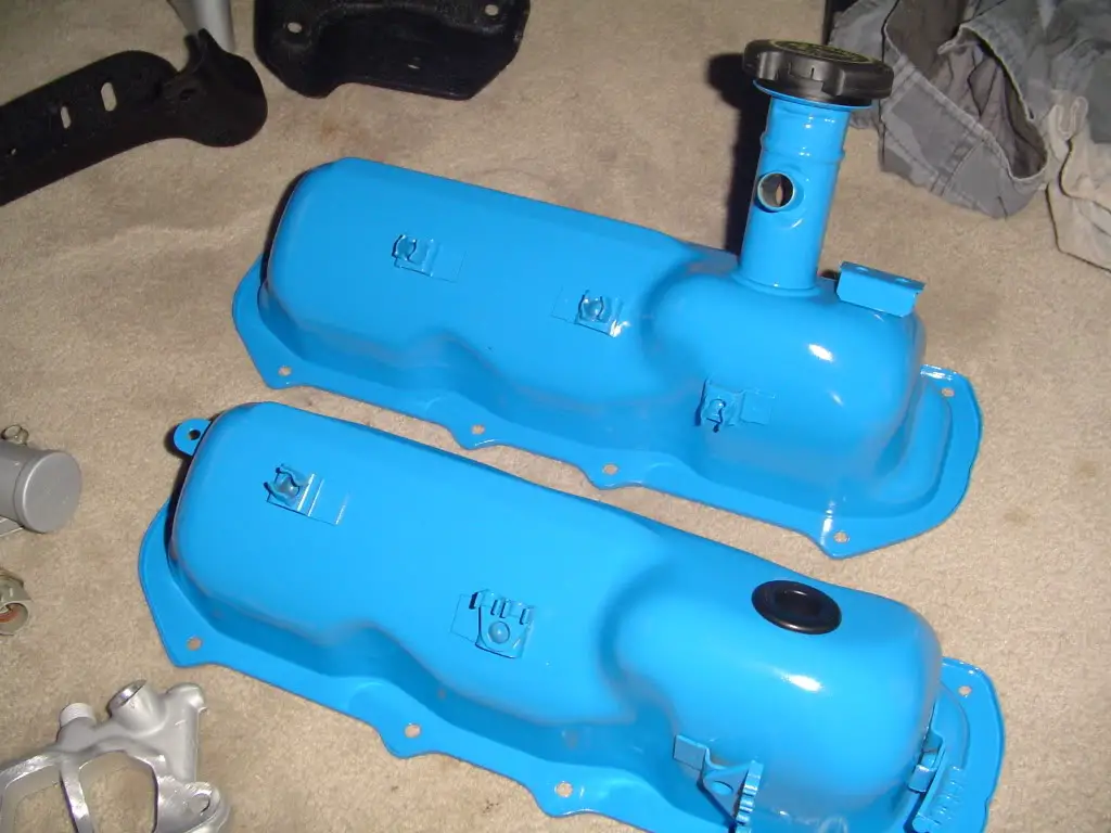

decided to paint some more stuff.

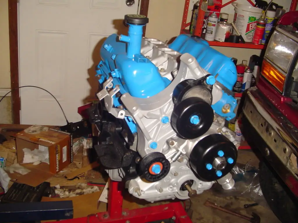

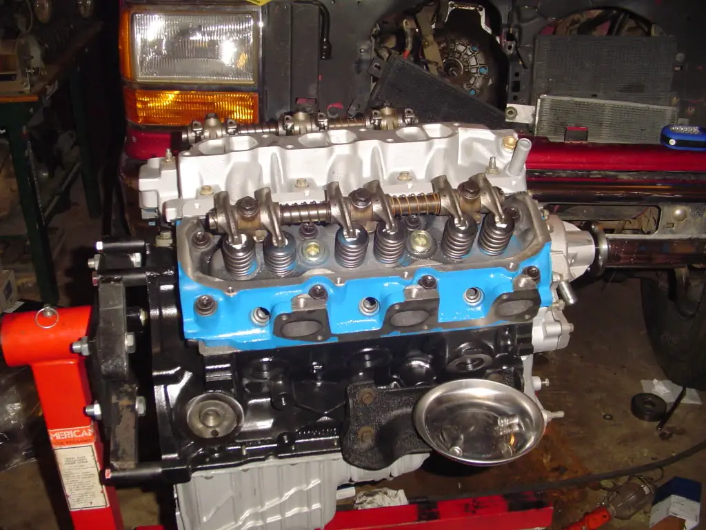

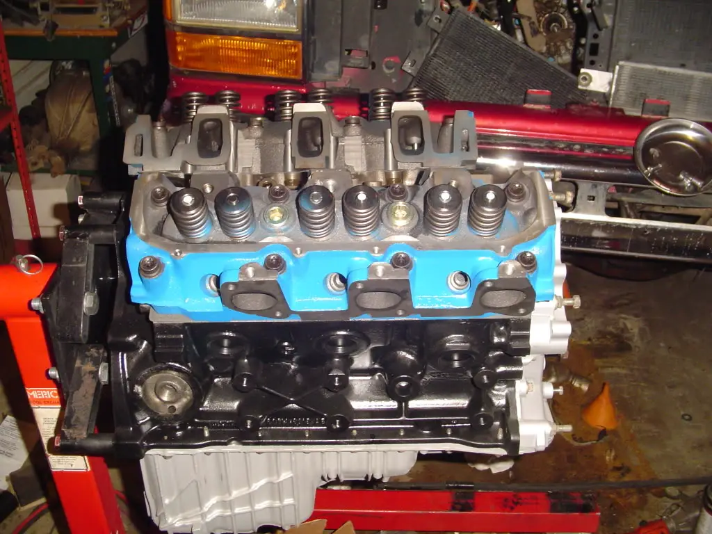

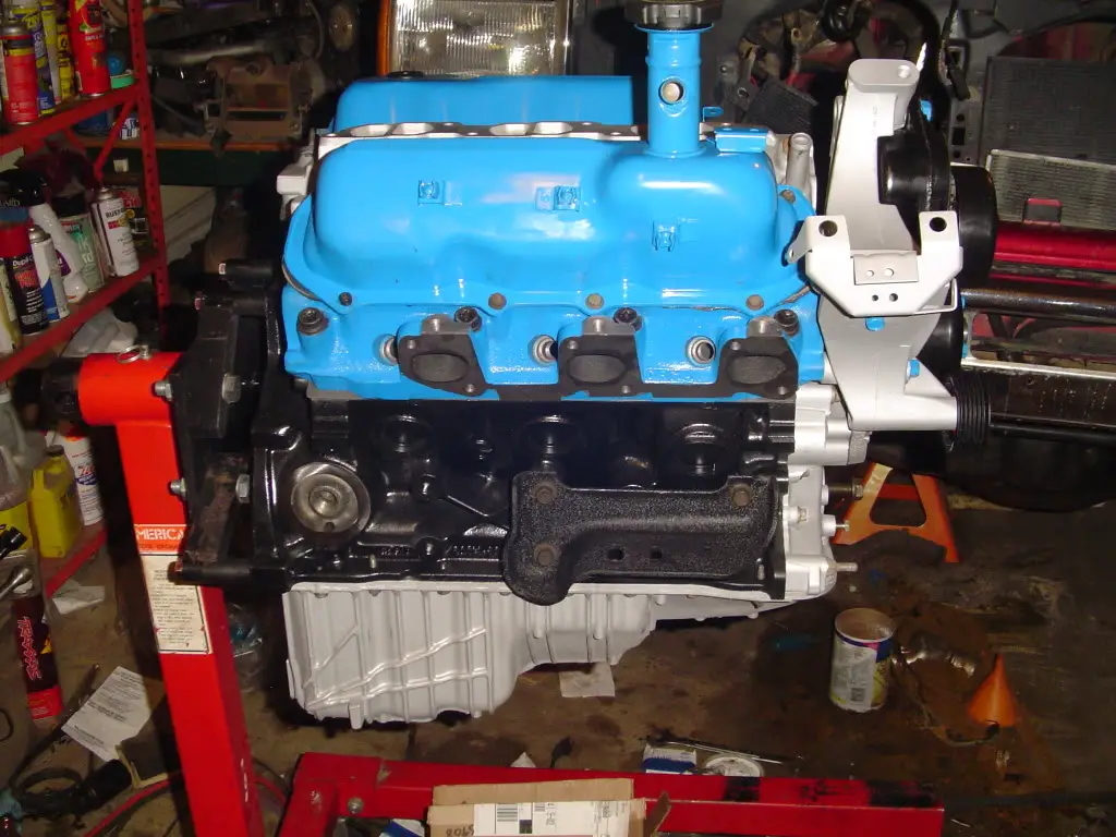

just about done....FINALLY!
i seriously was smiling the whole time this motor was being assembled. i know im a dork.
this is where i ended tonight. tomorrow ill finish it and get it ready to go back in the truck
looks really good. buy why is your idler pully grooved? mines smooth. unless theres another way to route the belt and it needs to be grooved there then?
Thanks! i noticed that too after i bought it. im not really sure, i was gonna take it back and ask for the bigger metal one. but after thinking about it more, i figured a smaller plastic pully is less rotating mass then the big metal one, ill just route the belt on the other side of it to utilize the grooves.
any luck with routing it? im interested to know if it works or not
well im not sure yet. i dont see a reason why it shoulnt work. if it really doesnt work then ill just buy a metal one, or make one out of aluminum on a lathe.

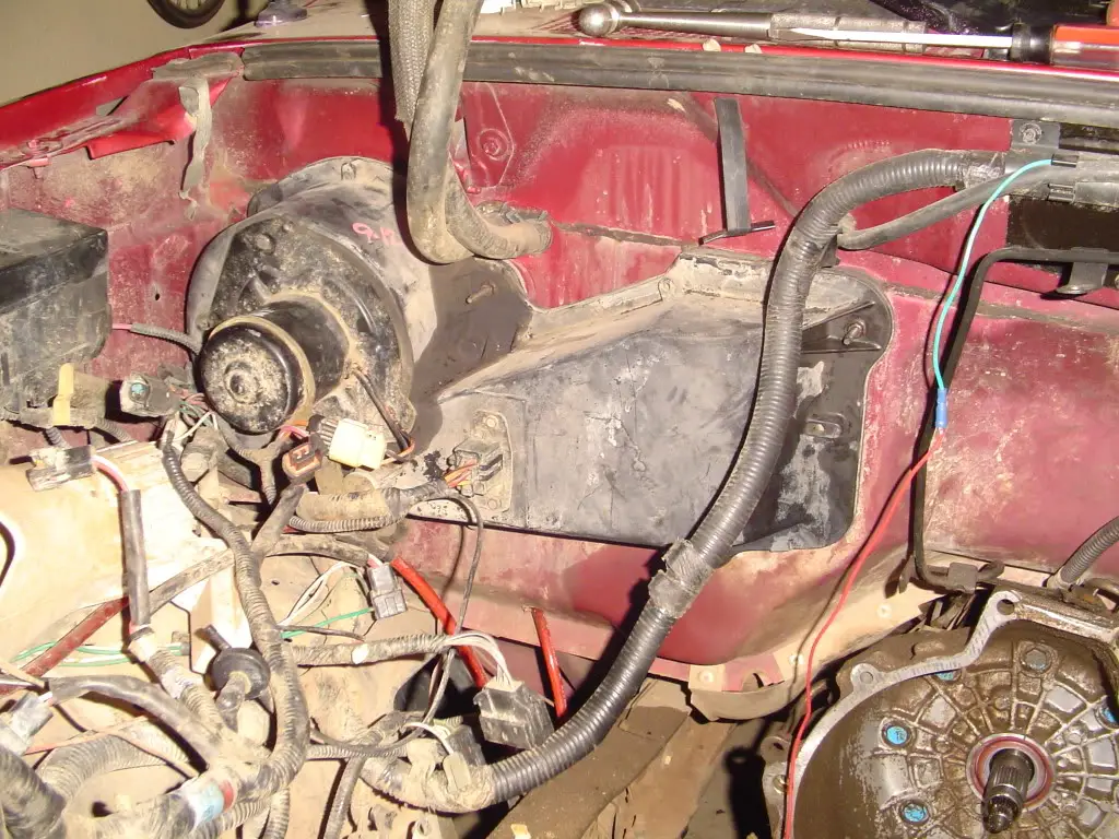

dash is all put back together and finished with gauges are installed. factory oil pressure and water temp gauges are non functioning.
non A/C heater box was installed.

Thanks man. i did that box because i saw yours. i was going to just leave the A/C stuff there...but nahhh!
I did actually clean it, when I got it that thing was nasty! I saw no sense in really cleaning it up, now it just matches the rest of the engine bay.
