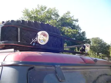

roof rack time!
why pay nearly 500 for something when you can make it for 50!

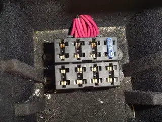

i finally got around to powering up that switch board in my center console, i used 4 gauge from the battery to the console where i split it into an aux 8 port fuse box. then it goes into the switches. i have 2 fuse spots left over in case i decide to add something, but i doubt itll happen. 6 extra things is a lot!

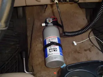

and just in case something DOES mysteriously ignite...i got this

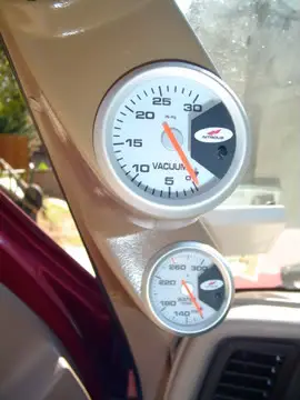

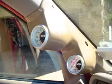

i also picked up these! had to paint the pillar pod and this was the absolute closest color i could find. the top one is a vacuum and the lower one is water temp

coooool! good work on the extinguisher. I need to get one of those too. Every rig should have one, no question.
Any chance on a write up for the Temp gauge?
I'm sure I can get on it tomorrow or Saturday when I power up the LEDs. I don't have many pics but i'll try to maybe take it apart or post some diagrams. Also where to splice wires into others if it will help.
after what seems like forever..slaving over this hot computer...;)
i managed to create some type of a write up for the temp gauge. it mainly applies to a first gen expo but im sure you can get the gist of it.
