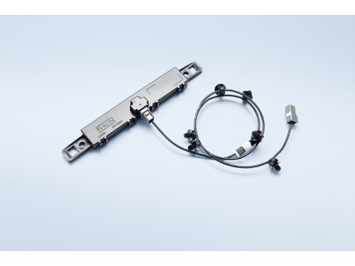

Mines a 2011. What it does is extend the range or make the range of the factory keyfob more reliable, it wont extend it by much, it has to be placed at the top of the windshield or under the headliner so the wire has to be extended. You remove the back of the center console off by pulling the top part back and it pivots away from the floor, youll see the tpms module at the bottom and just plug the wire in. The real issue is the keyfob, the built in antenna just doesn't have the range.
Don't know if you have to have remote start activated for the vehicle to use an external antenna since I already had mine activated when I tested it, the range wasn't increased by much but worked slightly better through walls and when it wasn't in direct line of sight. I was only testing it so I just had it dangling off one of the seats and not in the roof area for greatest range.
Remote Start System - RFR Antenna Kit DA8Z-15603-A

the shortest range is the built in keyfob, from there you can add an external antenna to the TPMS module at the back of the center console to extend it to maybe double, the problem is the antenna wire is too short so ford also has a longer wire so you can run the antenna higher up or add wire and extend the antenna to the top of the windshield or under the headliner. The other option is the long range antenna just for the remote start which you need to buy the alarm module for and the last option is the cell phone module which obviously you can use your phone to start(you also have to buy the alarm module to use it).
Anyways the factory key remote didn't give me enough range so I tried the add on TPMS antenna module, it really didn't increase the distance much at all, just made the signal a little more consistent, so I went with the alarm module (which you have to buy) and add on antenna with a separate remote that confirms if the vehicle has started.:)
There are two types of antennas, the basic one that attaches to the TPMS module which basically does nothing for range is about 6" long and 1" wide and do not need to buy the alarm module to work (think its been discontinued for the Explorer but its the same as the F150s). Main problem with this one is it doesn't increase the remotes range since the antenna is fixed. The other antenna is about a 2" square box with a 2" stub sticking out of it which is the long range antenna that attaches to the add on alarm module.. confusing isn't it :eek:

Not sure of its been pointed out before but the add on antenna for the alarm/start module only increases the range for the separate remote start fob, not anything else. The TPMS add on antenna may slightly increase the range for the all in one keyfob with the start and lock/unlock buttons and nothing else.
