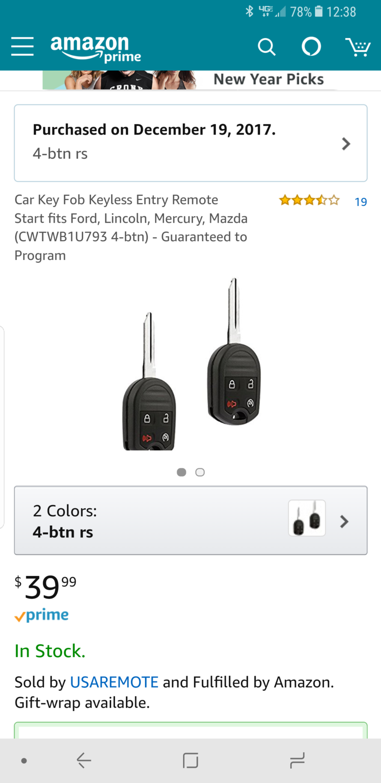

I did go ahead and buy a pair of keys from the "USAREMOTE" vendor sold through Amazon as above - however, my explorer has a power lift gate, so I needed the 5 button version - which is what I bought.
I went though getting them cut, programming them to start the vehicle in the ignition, and getting the remote buttons to work.
With the first pair of keys I originally bought through ebay, only the first one I programmed (#1) will start the vehicle remotely using the button on the key.
The 2nd one I programmed at the same time as the first (#2) , and now both of these new keys I just bought from the vendor above (#3 and #4) all work exactly as they should, except that the remote start button does nothing on #2, #3, or #4.
I kind of doubt that I am only allowed to have one remote start key that works - but maybe that is it?
If not - does anyone have any suggestions? How do I get the remote start buttons to work on the other 3 keys?
