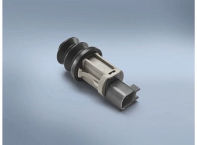

Can someone post a photo of where the hood pin is and what it looks like please? I searched back thru this thread and there is no indication about what to look for.
Also found this picture.
Peter
Peter
Yip. I have that under my hood. I'ma gonna go there and rqust to hook it up to the computer and activate it. If they blow me smoke, I will request that if it works to do it for free, and if it doesn't, I will pay an hr charge for trying. We'll see what they say.
