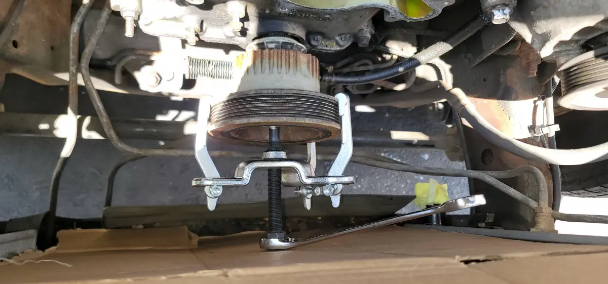

re iterate tension
snapped a 3/8 to 1/2 inch adapter righty tighty
Post #22 Picture of Breaker Bar with Cheater Pipe aligned and ready for Crank Pulley BOLT REMOVAL.
*DISCONNECT COIL so the engine will not run!
* Snug up/pre-load the 1/2" breaker bar and cheater pipe up to the top of the driver's side frame rail,
* Go inside cabin, and hit the ignition switch.
NOTE: Sometimes all the planets are aligned, and your pre-load is precise, this method works the first time around.
Sometimes it takes two or three attempts due to the socket/breaker bar coming off of the Crank Pulley Bolt.
DO NOT under any circumstances have anybody hold down the breaker bar/cheater pipe when attempting to do this!!!
