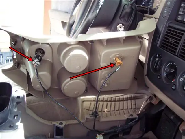

Hey Big Rondo,
I just wanted to say thanks again" for your write up on how to repair a Blend Door Actuator on the" 02-05 Explorers. Your instructions to do this fix were right on the money! I had one problem though as I attempted to repair this myself, my big shoulders, chest and 270lb body(from decades of eating chicken wings, I live in Buffalo can't avoid them :) and from 30 years of lifting weights in the gym wouldn't allow me the room and flexibility to reach up under driver side floor boards and dash to remove the Actuator itself, so I gave up and called my mechanic to finish the removal and installation of the new Actuator. I got as far as removing the console and harness plugs, dash bracket and plastic heat vent in about 35 minutes, but just didn't see enough room for me to get in ther properly for the Actuator removal. There was very little room between the back side of the dash and Actuator, could barely get my finger behind the dash. I thought of cutting out the dash like in your pics, but I didn't think it would give "me" that much more room to work with. My mechanic quoted me over the phone about an hour labor ($75) to R&R the Actuator only(I told him I would reinstall the console and other parts), so I took it to him today for the repair. I tested it and it works great now. It actually took him (his helper did it) 3 hours to do it, was tougher than he predicted, but he said he would only charge me 1 1/2 hours labor and asked me if I was okay with it and I said yes. I trust the guy, he's honest. I wasn't freaked out by it anyhow, because I still got it done a lot cheaper than the $680 the Ford Dealership quoted my a few months ago. The Actuator cost me $88 tax incl at a local Ford Dealership and $120 for labor tax incl or $208 for everything, not counting my own R&R on the console parts but I'm retired and have nothing but time. I also purchased the Actuator from Ford using my VIN number as you have reminded people to do. If I was a little smaller built and flexible, I probably could have completed the job myself following your excellent instructions. My mechanic was also impressed with your detailed instructions and photo's of each step to follow. I showed him the copy of your post I printed up a while back. Thanks again!
I do have one question for you, while I was removing the upper half of the center console and I got down to the wiring harnesses for the console buttons, I noticed an orange colored harness plug that was not connected to anything and it was taped off against the side of some harness wires. Do you know what device that orange colored harness plug would be connected to if I had that device in my Explorer? Just curious here. Thanks again for the past help!
BTW, Congrats on your Bruins winning THE CUP! I'm a diehard Sabres fan since their inception in 1970, but I was rooting for the Bruins verus the Canucks since I could not stand to see the Canadian fans riot worse had they won the cup, than they did losing it. It reminded me of my younger days working as a bouncer in downtown Buffalo nightclubs and having to throw numerous drunken Canadians out of the bar after Montreal or Toronto verus Sabre games on a friday or Saturday home game. Watch out for my Sabres this year, great new owner with loads $$$$ of money and isn't afraid to spend it on quality players. Gonna be an interesting season.

Hey Big Rondo,
No problem at all! :D:thumbsup: Glad I could help out.
I believe the orange connector is for the cigarette lighter if you have the smoker's package:
I was real happy that the B's won the cup! Good luck to the Sabres this year. ;)

Big Rondo,
>>>>>>>>>I believe the orange connector is for the cigarette lighter if you have the smoker's package:>>>>>>
I do not have a cigarette lighter on my console (not a smoker anyhow), so that must be what that orange colored plug is for. Thanks for the tip. All of my plug connections to the console are now connected to their power sources and working fine. When I removed the upper console, I found every plug harness disconnected and the plugs were just laying loose under the console. This the reason my Advance Trac off button never worked when I tried activating it a few months ago, but it works fine now. I think the person who owned this vehicle before me must have had kids or something that were playing with the buttons on the console so he disconnected them. The strange things you find when you buy a second hand vehicle. Thanks for that photo by the way.
>>>>>>>>>>I was real happy that the B's won the cup! Good luck to the Sabres this year. ;)>>>>>>>>>>>>>
Thanks, same to you on the Bruins as defending champs.
