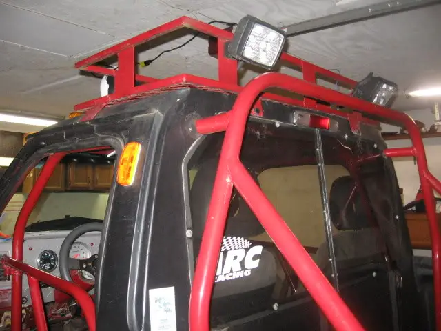

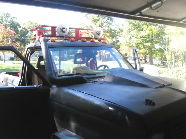

Do you believe this, I can't even get into my new garage :eek:. 3" body lift + 33s + roof cage = 1 damn inch to high to clear door.
Now enter high speed grinder with cut off wheel + drill + one big hammer = 2 inches less :)

I cut down the brackets on the roof cage, so now it lays allmost flush with the roof.

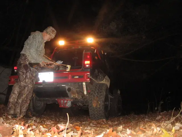

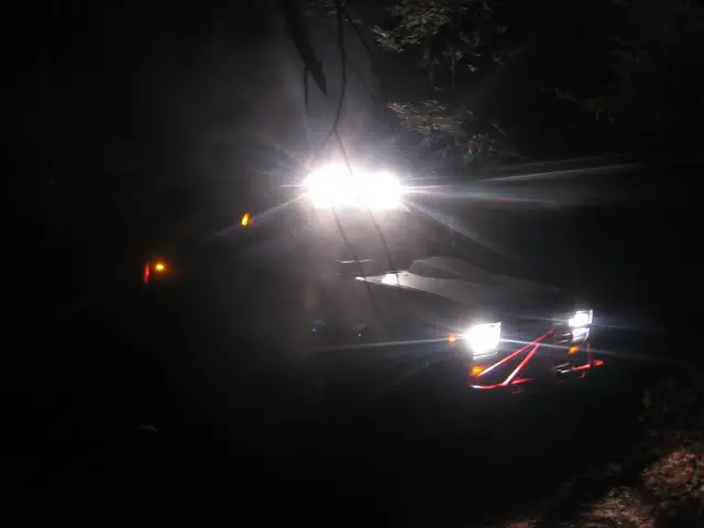

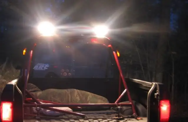

Hey I really do use these lights :D , there not all Bling:rolleyes:. They really shine during the early morning and late evening trail rides during hunting season. No pun intended. Don't want to run over Bambie and her mother.
Those rear located Hella work lights come in real handy when getting all your coats and gear together. And those those front roof cage Hella driving lights really light up the Forrest floor.

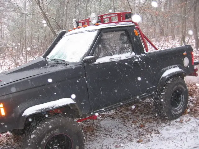

Love it! Fist time in the snow.

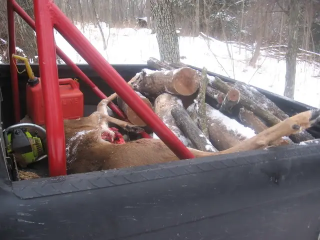

Went out hunting and getting firewood on my hunting property that I lease with some other guys.
I figured that I would have to air down the tires and keep a full or near full tank to get traction to the back wheels. But after that it went fine. Now in this pick it just started snowing. We only had about 5" of snow. The deeper it got the better it handled.
Now here she is bringing home the bacon, or should I say venison with a small load of firewood. The firewood is an added bonus on this farm. They let me have all I want for my wood burning stove in the basement as long as I get the old timber that has already fallen. And there is a lot of fallen timber on the 400 acres. No cutting of live trees. I have a floor grate that lets the heat flow upstairs. This beats turning on the electric baseboard :D.
After the hunting season it will be full bore on the B2 again. One person couldn't belive that I loaded the back up with fire wood and a dead dear. "Hey this was not built to keep clean buddy". It was built for a work truck also.

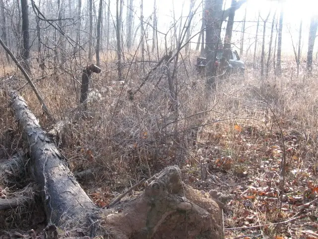

Here it is backing up thru all that scrub getting to that fallen down Shagbark Hickory to cut up for fire wood.

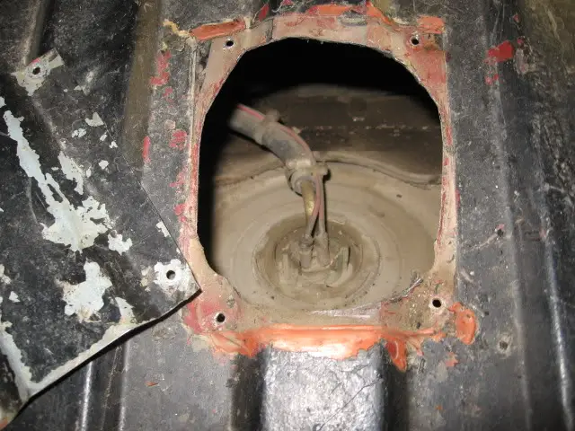

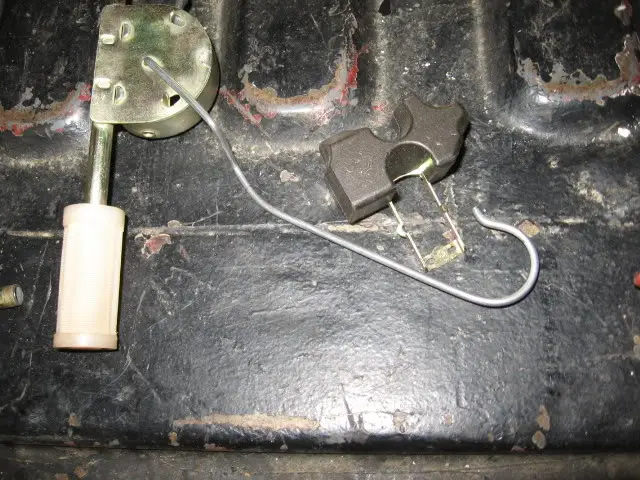

You are looking down at the rear bed of the B2. What you see after I took off the access plate is the top of the gas tank with the combo fuel gauge sending unit and outlet tube.
I knew at some point I would appreciate this access cover that I made. Did not like the idea of draining and pulling tank to get to this unit. Well now was the time, but what happened next I did not expect.
My Autometer gauge was not reading right so I wanted to inspect the sending unit. No biggie just remove cover and pull out. . . Wrong!

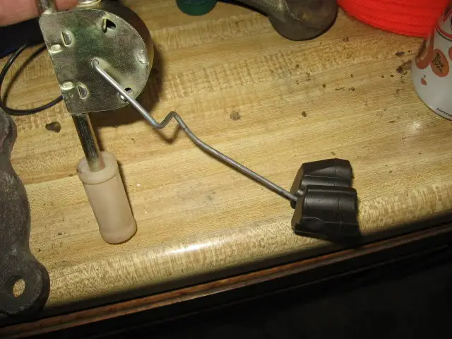

When removing unit I hit the side of the tank with the float. Splash.

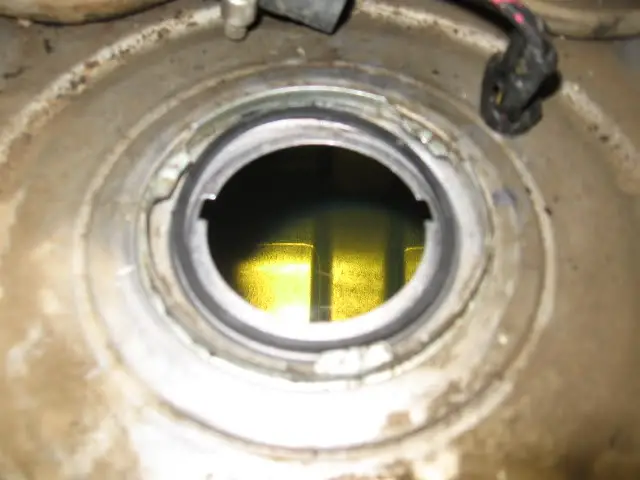

Last thing I saw was the float, floating away.
Looking into the tank waiting for float to float by. I tried everything to make that float come by. No way, just heard it hitting side of tank. Used coat hanger and even an air hose. Just too much fumes also. I had enough. And I was not going to drain and drop tank. That float can float in there until the cows come home.
Here is the sending unit less float.
After a short ride to Autozone where they all know me by first name. Wonder why. I showed Dave and he said we don't have any floats, most people don't need new floats. HA HA. But for $90 we can get you a new unit. Now this is already a new unit as is the gas tank and damn if I'm going to buy another one. I told him since I don't drink anymore I'll just un-cork a bottle of my Moet Chandone and use the cork. But as usual Dave came up with an idea, a carburetor float. Just snipped off the brass hinge and wrapped the wire around it and Bingo, back in business.
Oh ya, one other thing. It was just a simple grounding problem, not the unit.
My Autometer gauge was not reading right so I wanted to inspect the sending unit. No biggie just remove cover and pull out. . . Wrong! When removing unit I hit the side of the tank with the float. Splash.
Does the float have anything steel on it? I've attached magnets to the end of a coat hanger before to reach screws I've dropped in the engine bay and stuff like that.

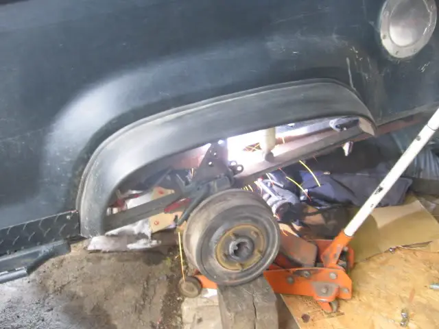

Was out bouncing around on some trails with a load of firewood and I thought the rear end felt a little squirrelly.

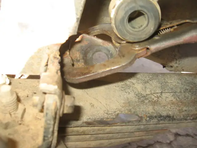

During my haste to get this thing tagged and on the road. I forgot to finish welding the driver side outboard shock tabs to the upper spring plate. Both were just tacked on. I'm getting ready to weld the inner tab on now. The shocks are directly over the leafs. Oh well, it was a nice day to weld outside anyway. No need to weld in garage if I don't have to.
Just waiting for some $$ to turn loose and I'll be back at fabbing some stuff to the little beast. I really miss all the fabrication work. I'm just as pleased building on this as wheeling it.
Welding broken shock tab. Well had I not forgot to arc weld it after just spot welding it in, it would have not broken if first place.
What a difference that made. Now back to floating over those bumps. I'm using Rancho shocks.

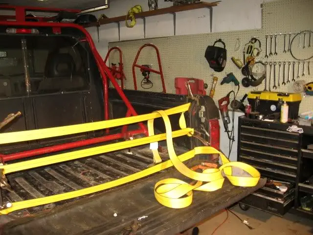

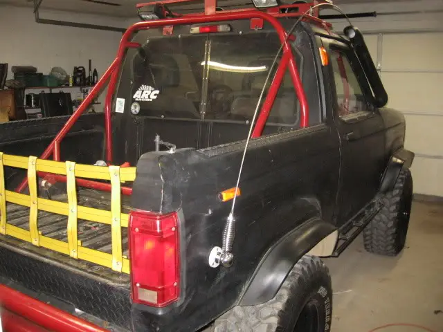

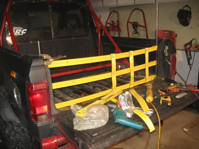

Thinking of making my own web tail gate so when I remove the metal Ranger one I'll have something back there. I looked at some for small pickups but I would still have to modify them and the ones I saw where not that strong looking.
I have some of this really heavy nylon webbing that I thought I could use. I just have it clamped on right now for some ideas. Was thinking of making loops at each end and then have some round metal rod that would go thru loops at each end and fasten somehow to sides. Then I would also have some vertical webbing spaced evenly along the 3 horizontal ones. Maybe like 4 or 5. The only problem is that I don't have a commercial sewing machine.
My idea would be to use small bolts to where the vertical and horizontal meet. Might not look bad at all. It would give it a tuff look. I could heat up a small rod and burn the right size hole in nylon. This would keep it from fraying. This thing would be completely removable also.
Any thoughts.
I would have ordered that netting in a heart beat had I not had all that webbing laying around. I bet someone else will jump on that.

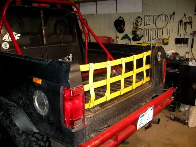

Starting to take shape. I looped the ends around some 1/2" tubing that you can see at each end. I drilled a 1/2" hole in the bed of truck and slid the tube down into hole. It goes about an inch and rests on part of the frame.
At this point I was still uncertain on how to attach the top. I think the Vise grips at one end and bungy cord at other would look a little tacky :D

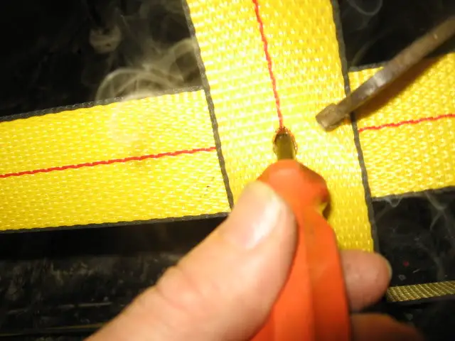

This is how I connected all the loop ends and crossovers. Just heated a scratch awl and then used a finished looking bolt. It has a flange that's integrated with the bolt head.
Done, other then to paint the metal tubing.
I went to Tractor Supply and looked at the hardware section and decided on a little steel hoop and a spring snap ring. The hoop is mounted to top of bed rail and the snap ring is attached to the tubing by small piece of metal rod about an 1/8" dia. that I just bent to wrap around tubing and then into the the other end of snap ring.
The trick was to get enough tension on the netting so it won't flap all around. You have to really pull the netting with some force to snap the rings in place. This netting will come in real handy when I start cutting wood again.
Oops, just noticed in pics that I have to trim some ends off. BTW I used a cut off wheel to cut all webbing. It is really some tuff stuff.
Can't wait to start on that spare tire carrier in rear of bed. It ought to look look cool with that netting.

Starting to install my CB radio. The radio needs some mounts made up to install at bottom of dash but does work. Got this 102" stainless whip antenna at Radio shack.
For now just got the end stuck down inside my snorkel
