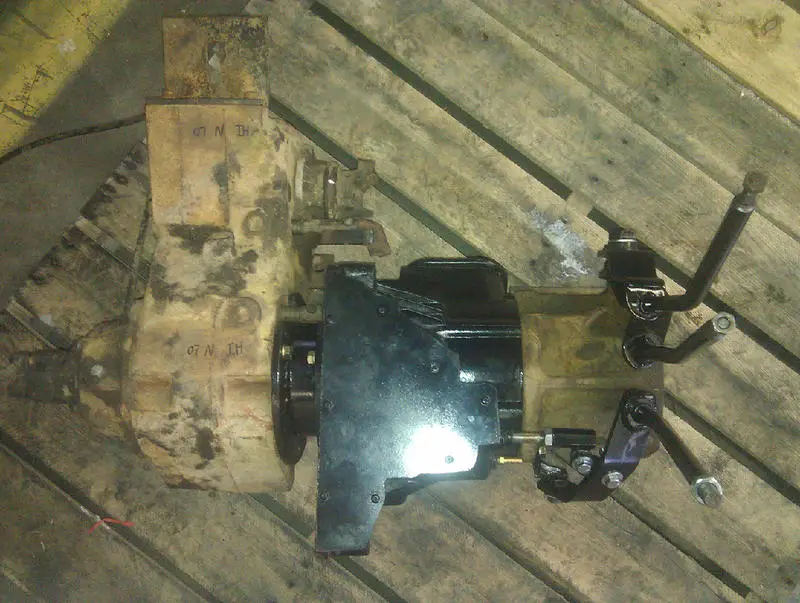

Ok just finally ordered my strong box, the guy Jake says he has made some for a few people with explorer/ ranger set ups. Another thing he does is he will make you a strong box that you can bolt a NP205 behind it and he provides a twin stick kit as well. (for front digs) The boxes allow you to clock your transfer case every 5 degrees and for the time being he throws in the shifter. I told him about this site and he is looking at becoming a vendor. His name is Jake and his number is 270 230 7015.

The Strong Box kit for Fords uses the stout 2.7:1 planetary gears from the Borg Warner 1356 transfer case. This kit is designed to be compatable with nearly all Full size Ford transfer cases, including the NP 205 transfer case, and allow use of the original NP 205 shift rails with little to no modification, even with most "twin stick" conversions.
