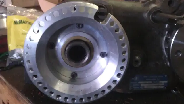

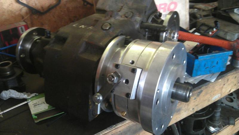

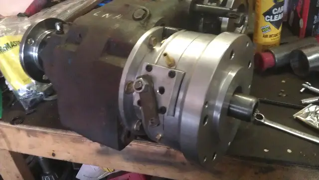

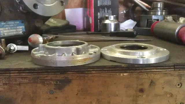

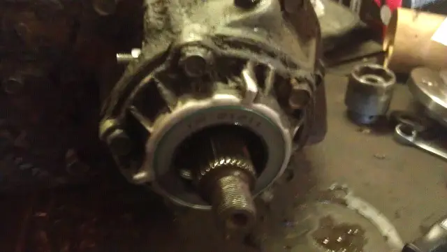

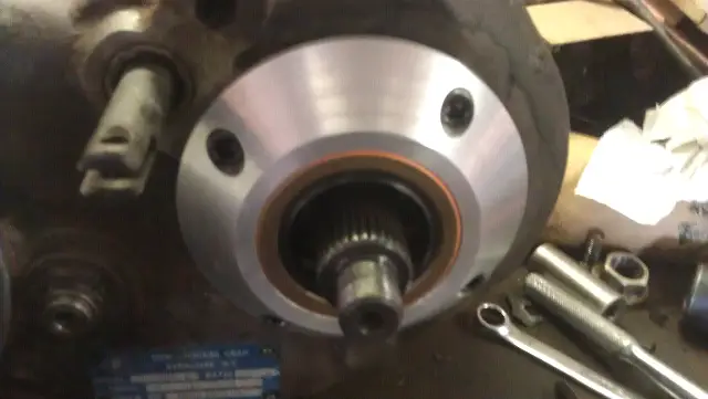

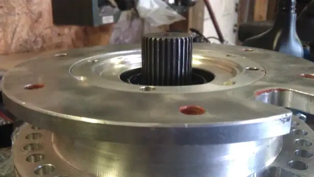

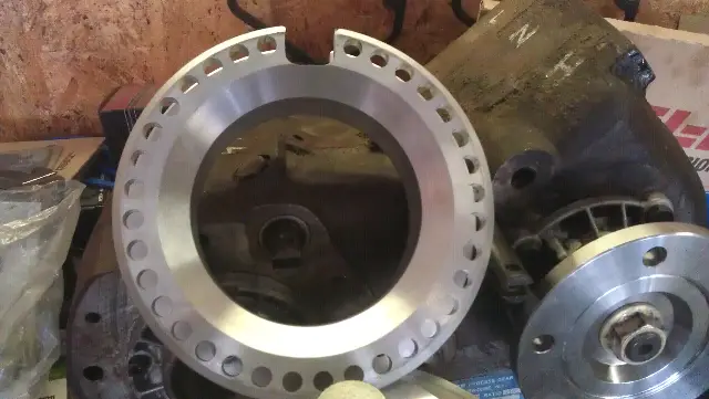

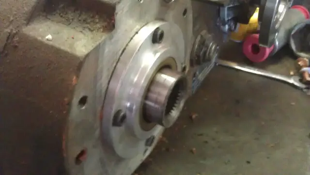

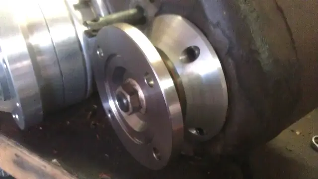

Sorry i have been so busy and i found this cool app that lets me navigate and put pictures from my phone so i have been testing it out.Sooo quick update my 205 has a what is called a double seal on the input side of it, in order to have the strong box mate up to it i have to pull the seals and of course i want a new seal so i ordered a new seal and have to press it in all the way, the reason why is because the strong box seal rides on the same shaft as its seal itself, so in a way it still is a double seal but also serving two puroses, i meased and tested the tolerances that jake had put into the box totally mating and creating a perfect seal for the box on the 205 and they are exact, i mean perfect machine work here. I still have to pull the rock flanges and install my front billet retainer and also the rear retainer with the new ring support. Any certain pics? I will be more than happy to oblige.
