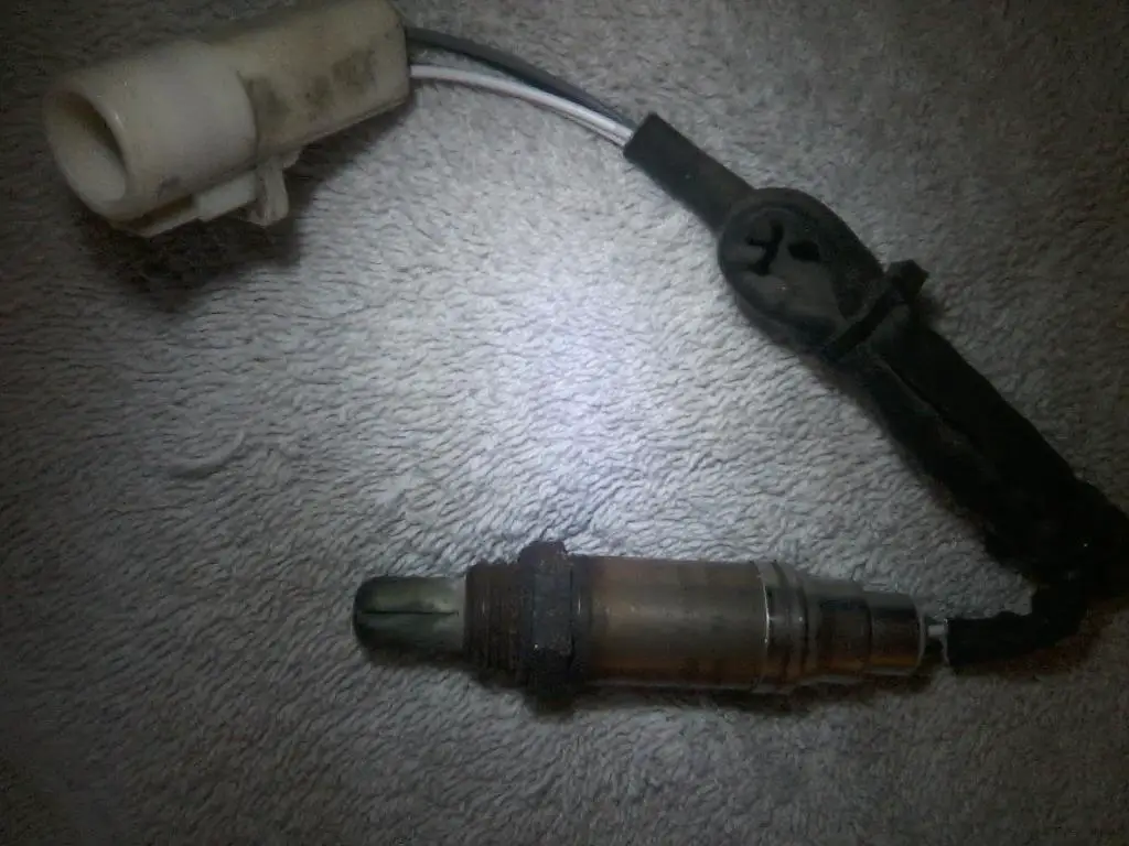

I also, replaced that o2 sensor on the RH side that was out of range. Looks like someone installed a downstream sensor in place of an upstream.
So I installed the correct Bosch p/n 13117 and low and behold the CL was off. I pulled the battery cables to reset the codes (and check the age of the battery).
