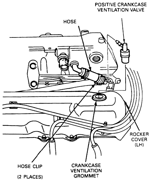

Anyone have any pictures of where and how to find the PCV valve on a 95 XLT? IS the brake booster line easier to access?
Thanks!
Thanks!
This is a illustration for the 4.0 L OHV

Using the brake booster line is very easy.
and where is this brake booster line?
brake booster cable is a tube that goes from the right side of the engine to the big black circle in the upper right corner. You disconnect it from the black metal circle, turn on the engine, and it acts like a mini vacum tube for you to slowly(slowly or else your engine will stall) pour seafoam in using a baggy with the corner cut or a small funnel.
You guys are awesome. Thank you so much for the info and have a great weekend!
