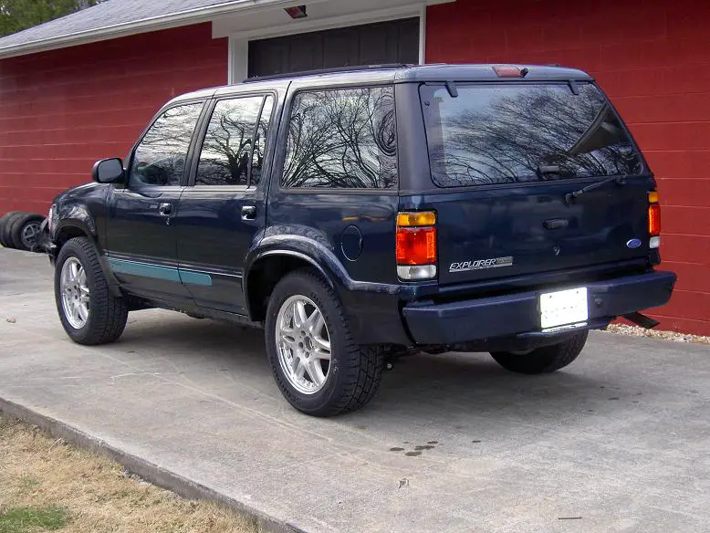

They are a bolt on, even the connector matches, though the number of pins will match the features. I have the 2nd gen mirrors on my 99, which has 91 LF door, and the rest a 93 body(doors and back). Mine's a Limited, so the heated mirror wire is there from the defrost circuit. I like the puddle mirrors, those are great.

I used the 1st gen doors and door handles too.
That 93 truck I had painted about four years before that, it was in very good shape then in 2005. Swapping in the 2nd gen key cylinders was a project, the holes in the doors and hatch are larger starting in 1995. I used a 95-97 hatch key cylinder in that 93 hatch, so I use the one 1999 key for everything like normal.
In the near future, I'll find a 98-01 hatch and bumper. I'll swap a 98 LF door I have to replace the old 91 door(rust along bottom seam), fill in the sunroof, and paint it all again, with the 2nd gen dark forest green color. It's still a nice truck, I saved it all and kept rust from starting on it underneath. I know it's a reconstructed title, but it's always done what I needed it for. Have fun with your projects, you can get anything done with effort etc.
