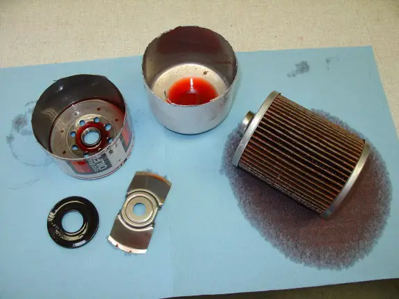

I changed the aux tranny fiter today. The ATF ( Amsoil ) that drained out of it was a bright red as new ( I actually compaired it in test tubes ). I also disected the filter ( a K & N ) and found absoultly nothing inside ( particle wise ) as has been the case every time.
EDIT: Forgot to mention 20k miles on this filter and ATF.
That's very interesting. It must mean that your trans. is in very good condition. :)

Opend the filter....Finally!! It had alot of dark fluid still trapped in it. Large particles trapped in the filter media. around the size of table salt and pepper. Some metal fragments. from something I have done in the past I'm sure. I tries the new housing with the 15psi by-pass. I have noticed no difference. I was wandering if my pump is weak or going would the added resistance cause a problem?
I am only reading about 30-48 psi at the filter. Is the normal running pressure suposed to be around 70-78 psi?
I know that I need a new TC and maybe a pump. Future project.
