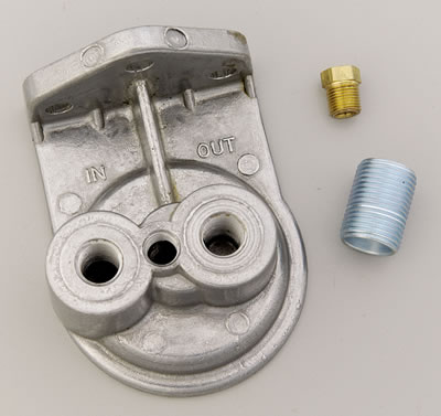

If you want just remote filter bracket so you can get your own lines and filter. Go to Summitracing.com type PRM-5021 in the search. The backet has the third hole for a temp sender if you want to install a temp gauge kit that you like. And not like those ugle ones that some remote filter kits come with.

Actually, my installation uses the same filter and filter head as the dieselsite.
The only difference is that I used rubber lines instead of the braided stainless lines.
My total cost was $43 Canadian. I bought ALL the parts separately and locally.
There is nothing wrong with the other kit, it just would have costed me more to order the Perma Cool kit, with shipping and exchange.

The temp guage would be more beneficial. I put the pressure guage on mine ($9.00 locally) already, and I'm going to be adding a temp sender into the filter head as soon as my guage pod arrives.
My filter head came with 2 threaded ports, so I can have both guages.
The press. guage serves as an indicator to when to replace the filter. If you just replaced that filter every 25,000 miles and didn't worry about the guage, that would work also.
If I could only have one guage, it would definitely be trans temp...
