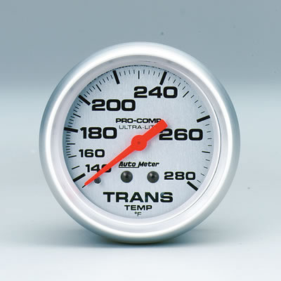

I have decided to go with Dekota Digital tranny temp gauge and mount in a custom fit place in the console.
That sounds nice. I can't decide if I want digital or analog. I really like this one:
Though I think that the Digital one will allow more of a inconspicuous mounting area that I can just kind of lean over and glance at. Real quick to read err I guess they both are.
idunno

Oohh that is nice. Wheredya get it. Did it come with the sending unit and if so did it bolt right up?
I have only seen green and red readouts. I like the aqua color. I think that is the one I want if I can't get the white face one.
