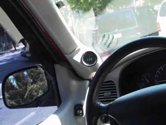

Here they are....
and Bill's last pic in this group.....
Whats involved in attaching the pod to the windshield piller?
Thanks....
Looks outstanding
hg
Gauge looks super
That gauge pod looks great.

I drilled it.
the pod comes with plastic push-anchors,I painted the head of the anchors with the same interior paint,and used those.
I really didn't want to drill it,but double sided tape was not working.
the paint match was dead on perfect,I ordered from
www.paintscratch.com I told them I was painting plastic and they gave me a primer and paint that would flex.
