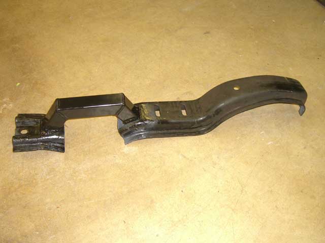

Another night in the Section525 Fab shop. It's been a while since the shops been open. But Phil got his doubler all in the BII so it needs a new front driveshaft and a modified crossmember.
Gentley grind into the weld wearing protective eyewear.
Should look like this. Don't go too deep.
Tap on it with a rubber mallot.
Cut it with a bandsaw. We chopped 14" of this one!
End put back in. Ready to weld closed.
Welded shut!
