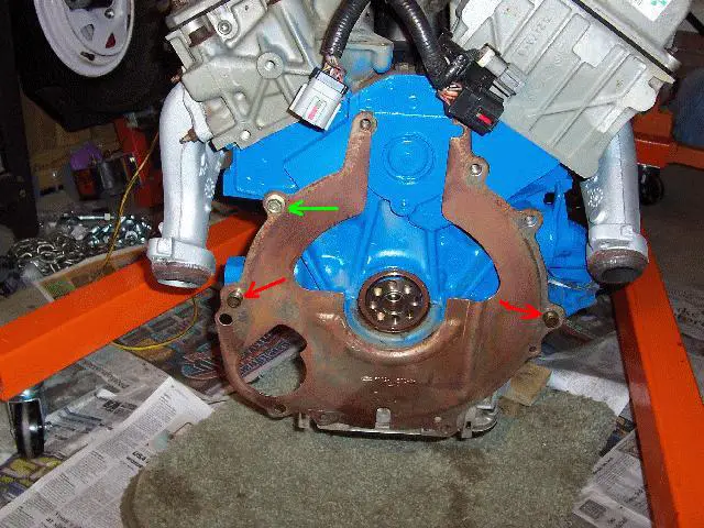

Spacer plate & engine drop in
The photo below shows the spacer plate that fits between the block and the transmission. When I was pulling the engine out the plate fell off the guide pins identified with the red arrows.
Since I didn't want the same thing to happen when installing the engine I used the short bolt from the rear of the head that attaches the ground strap to hold the spacer plate in place.
After using my chain method to tighten the flexplate to crankshaft bolts and the crankshaft dampener I started the process of returning my engine to it's home.
I left the upper intake manifold off to allow easier access to the O2 connectors and upper engine to transmission bolts.
The engine spacer plate is a PITA...
I didn't bolt it to the block although I wish I had... After it fell off the guide pins for the 30th time I used a liberal dose of Permatex Ultra Copper to hold that sob in place...
Since I was installing the shortblock into the truck with the tranny in place I didn't feel the need to go under the truck to retrieve it...

A guy on the uk part of the site posted this tip (Duncanofengland); take a chisel to hole and stamp the edge a little, just enough so it "grabs" the dowel. Do this both sides and it will hold the plate during motor or tranny install.
I wish i'd thought of that after the 10th time it dropped whilst trying to line the tranny up using a cradle i made and a trolley jack.

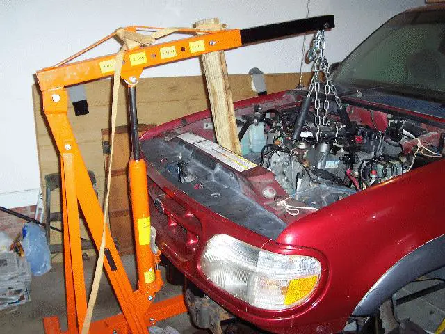

Short boom
I had to lift my engine back out to lengthen the rear lift chain a little. The angle wasn't right to line up with the transmission. The other problem I'm encountering is due to my short boom length. The engine needs to go farther aft than the length my boom can reach. I decided to try to lever it back. The photo below shows my 2x4 inch lever that pushes against the crankshaft dampener and pivots against the radiator support. Then I pull the top of the lever until the engine is in position and tie the lever arm to the crane.
Dale, Turn your hydraulic ram around the other way and you will pick up two inches on reach. Also if the end of the boom is open, run the chain through there and then into the bolt for a few more inches.
Excellent suggestions!
Well, as is often said these days: "Duhha!" Why didn't I think of that?
I'll lift the engine out again tomorrow and implement both of your suggestions and try again. That way I won't have to fight gravity and the crane will be all set up for my future rebuild.

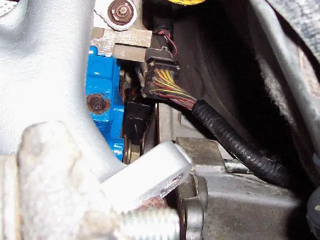

Docking the engine with the transmission is a tedious and time consuming task but possible to be accomplished by one person working unassisted. The spacer plate exacerbates the already difficult and somewhat aggravating exercise. To prevent the spacer plate from falling off the guide bushings I loosely fastened it on each side with very short bolts. I used the bolt that attaches the ground strap to the rear of the right head and the bolt that attaches the ATF tube support bracket to the right side of the block next to the motor mounting plate.
Once I got the engine lowered to line up with the transmission and less than two inches away I connected the electrical connectors at the rear of the block. The left one is shown in the photo below.

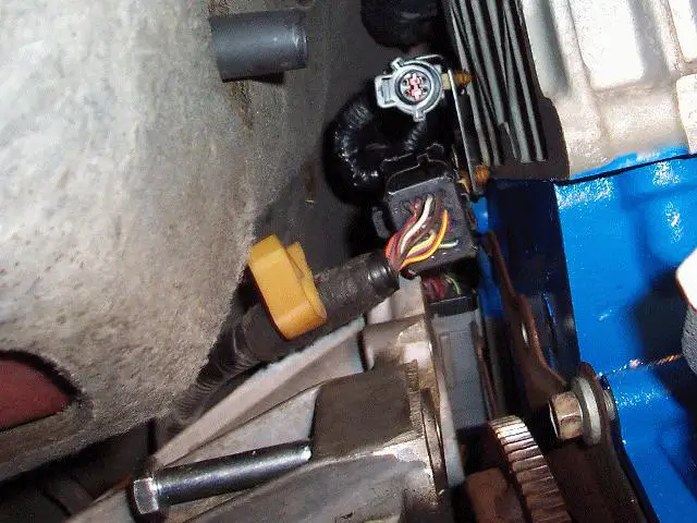

I had difficulty connecting the O2 wiring connector with its mating connector on the right side as shown in the photo below.
Apparently the sensor had been replaced with an aftermaket unit and the wire was extremely short. I ended up having to pry the mating connector loose from its mount in order to reach. The plastic clip will help keep it in position and hopefully from rattling. When I pull the engine again for my rebuild I'll have a replacement O2 sensor with the proper length wire to the connector.
Next I determined which side of the block was lowest (the left) and lined up the guide bushing with its mating hole. Then I inserted one of the 75mm long bolts I used to mount the engine on the stand in the hole opposite the short bolt as shown in the photo below.
Next I removed the short bolt and started threading the long bolt into the block. Almost immediately the spacer plate slipped off the guide bushing but slid onto the long bolt as shown below.

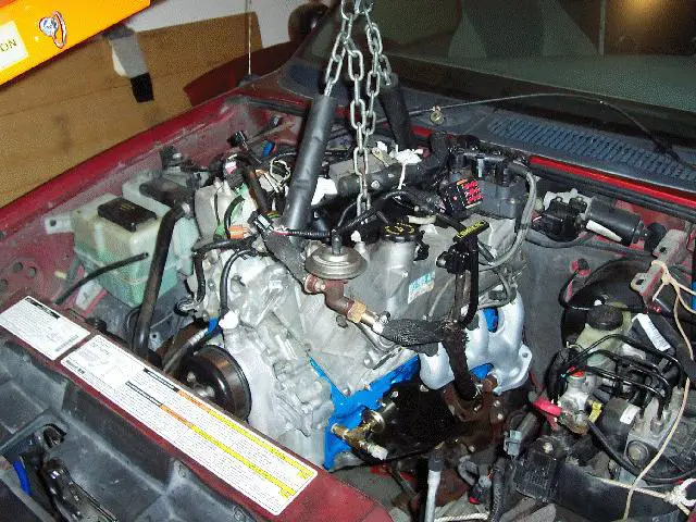

In order for the engine crankshaft to receive the transmission shaft the two axis must be aligned. The angle of my engine on the crane is slightly off (too low in the rear) so I will use the long bolts to support/align the rear of the engine with the transmission as I lower the boom to achieve the correct angle. Also, the left bolt will force the engine to rotate slightly as I lower the engine to align the right side guide bushing. Then I'll remove the short bolt on the right and insert the long one. I believe the transmission shaft must be aligned first since it appears to be the longest. I suspect the torque converter bolts must be aligned with the flexplate second because they appear to be the second longest. And finally the guide bushings must be aligned before everything will slide easily together. The engine to transmission bolts should never be used to force the engine to dock because the torque converter bolts may not be aligned and using force might distort the flexplate.
Engine docked!
The engine is finally docked to the transmission! I have the lower 6 transmission/engine bolts snugly in place and the engine is partially resting on the motor mounts. I was very lucky that the torque converter bolts lined up with the flexplate on the first try. I didn't have to rotate the crankshaft at all. Next I will insert the upper two transmission/engine bolts and then torque as many of the eight bolts as possible to specification.
