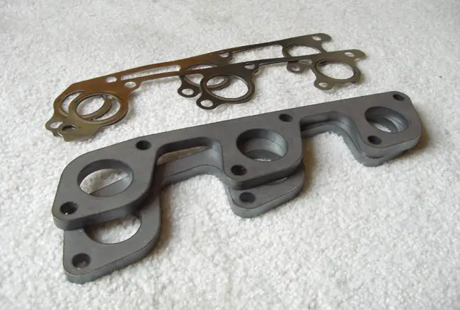

The header flange is in the mail (from the awesome canadian dude with the CNC laser) and should be here by the end of the week, along with the oxygen sensor weld bung. I'm holding off on ordering the muffler because that'll just go wherever there is free space so I dunno what the dimensions are yet.

Header flanges -- 3/8" thick of prime Canadian beef :thumbsup::
Nice
