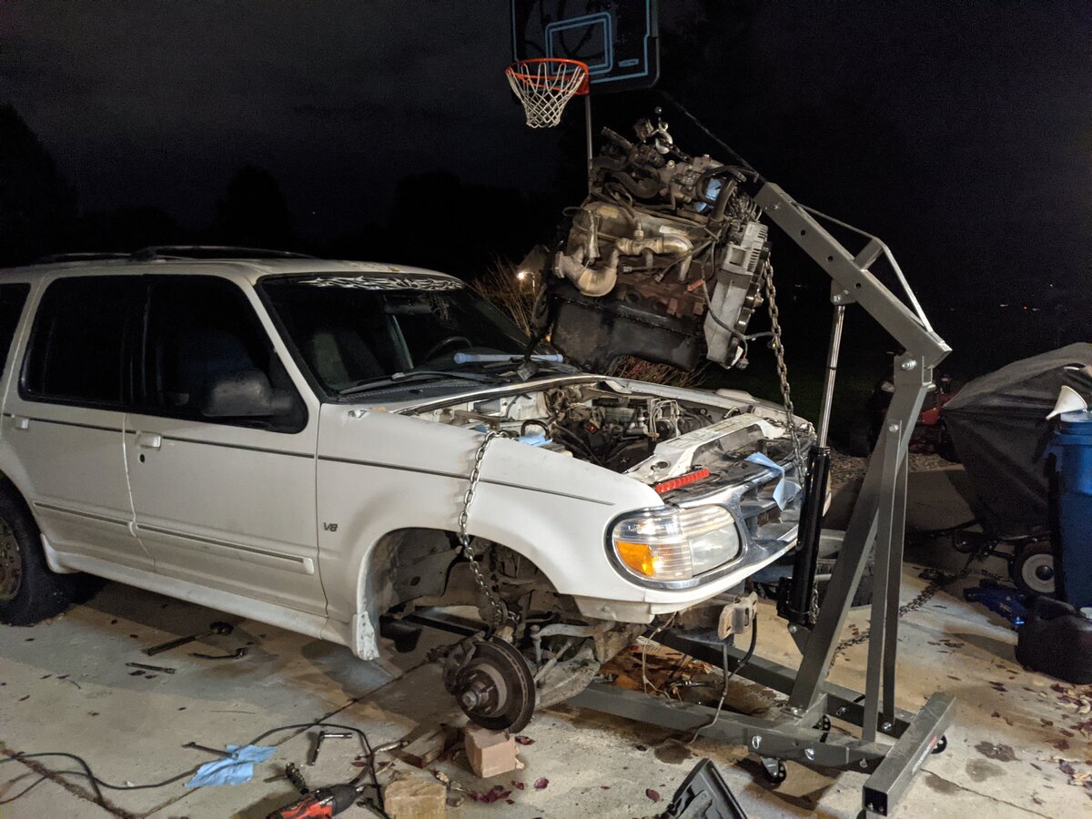

Well got a bit done today. Finished pulling out the engine. That's a huge pain with my harbor freight hoist, its right on the weight limit and the hydraulic piston kept stopping. I would pump it and nothing would happen, wouldn't even feel resistance.

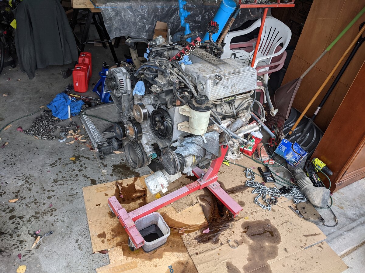

Well, still waiting for the last bushing for the transmission, so I decided to get started on the engine. Got a few photos as I was going

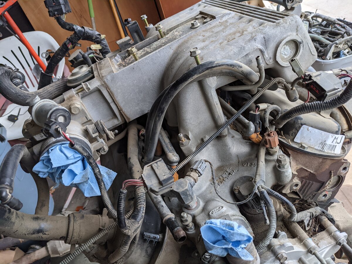

First thing I noticed when pulling it apart was that it was overall rather clean, and the upper intake had a lot of shiny grade 8 bolts. Either they are not original, or it was just really clean. First time taking off a metal upper, so I cant say for sure.

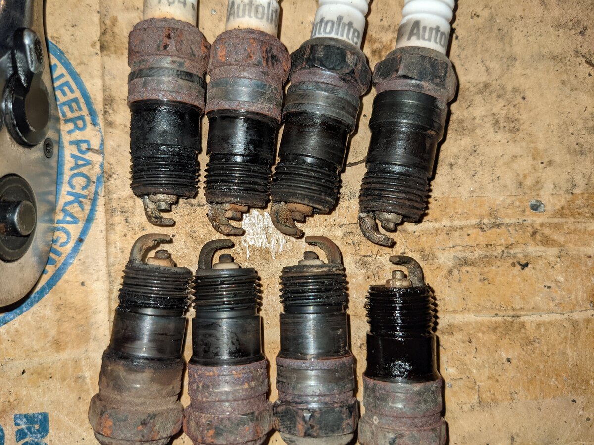

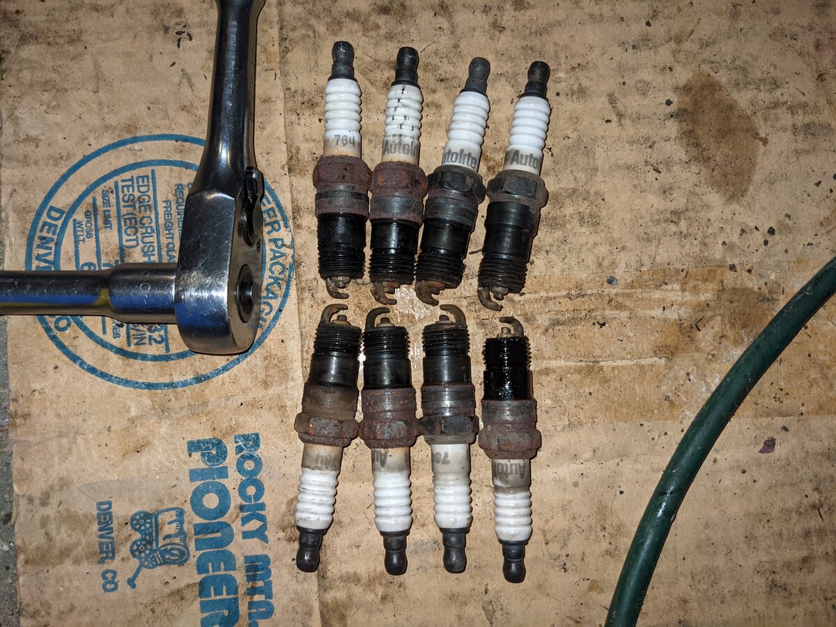

Also found that the spark plugs, while very warn, look like they were in a solid engine, again backing up what I felt when driving it. Happy to see that.
I just noticed the oil in the #8 cylinder when posting the photo. Will need to check that again in person.
Otherwise it went mostly smoothe. I have the upper and lower intake off, along with the valve covers and oil pan. Will be replacing all the seals and hoses as I put it back together.
I did have 2 of the upper intake bolts break when I went to remove them. I think i'm just going to bring the engine to a machine shop to get those taken care of. This is not the first time the 302/351 lower intake bolts have broken on me. With the engine already out of the truck id rather somebody else fix it this time.
I do already have replacement studs on the way to replace the lower intake bolts. Part of the reason I took off the lower intake was to take care of any broken bolts while it was out of the truck and replace them with something new.
I might be able to run the engine to a machine shop this week still, but that is probably about all I will be able to do till middle of next week. I hope I can get this all wrapped up before it starts snowing.

Nice! That looks pretty typical for a well used 5.0
Those bolts always look clean inside the intake, only the heads are exposed.
The front two lower intake bolts, the double post ones that hold the coil tripod, those go down into the water jacket and get corroded, so they often break.
Those spark plugs look pretty rough! How many miles were on this donor? Lots of deposits, something we should not see in a smooth running 5.0
good thing its getting a refresh now!
solid work thus far
Before you take the block into a machine shop to have fasteners extracted make sure you remove the timing cover. There are 4 bolts that go through the water pump and through the timing cover, and again into the water jacket. Those suckers like to break off as well.........
