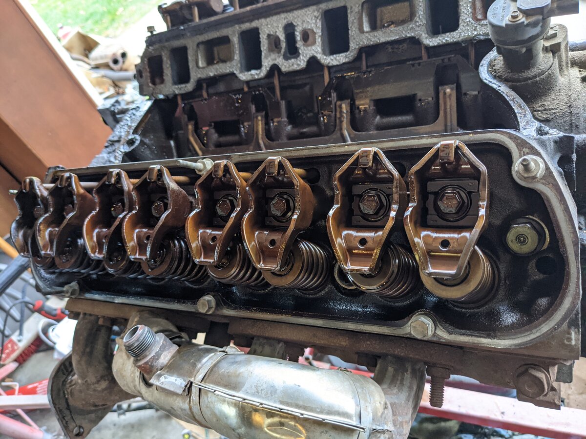

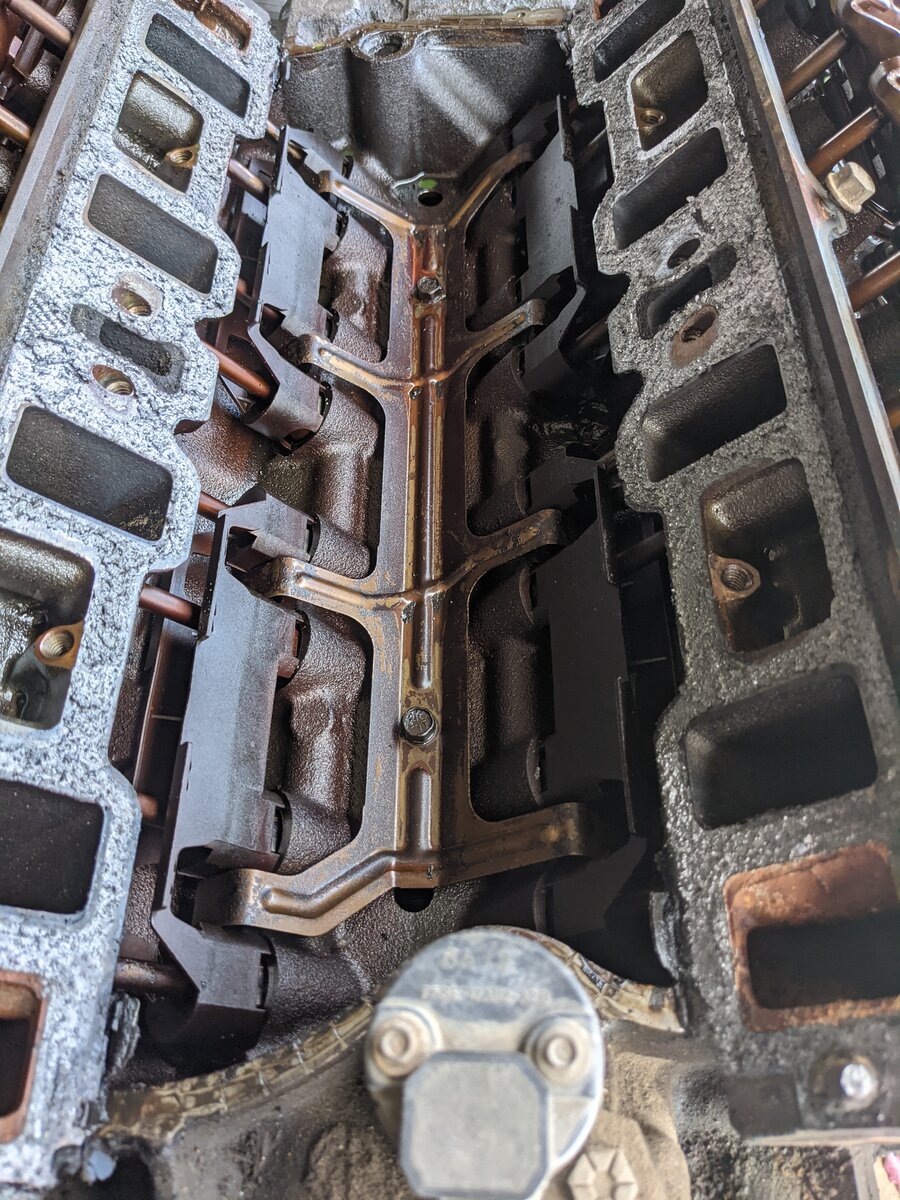

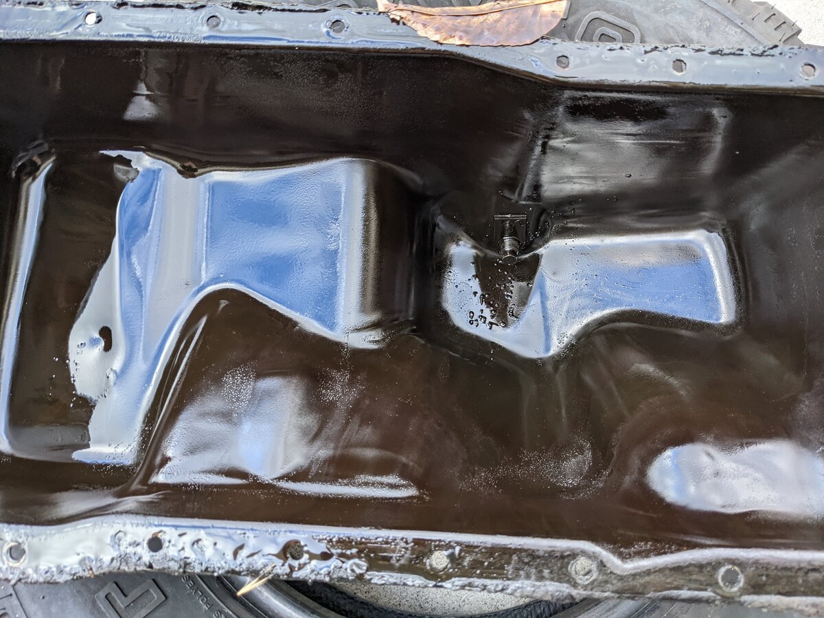

Bit of progress made. I have the lower intake, valve covers, oil pan, and thermostat housing, injectors and rail with new rings, new pressure regulator back on. I've been working on getting all the rubber hoses sourced and replaced, and i've started to get the wiring harness back on.

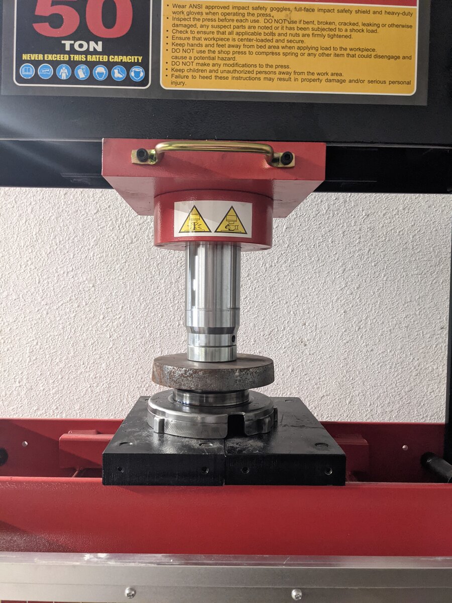

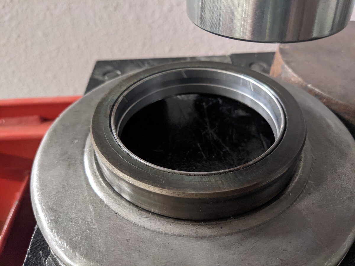

Im a touch held up on the transmission right now. Everything that goes inside is put together and ready to go, but the planet gear assembly that I ordered ended up being for the wrong transmission. I have a new one on order and it should be here soon.

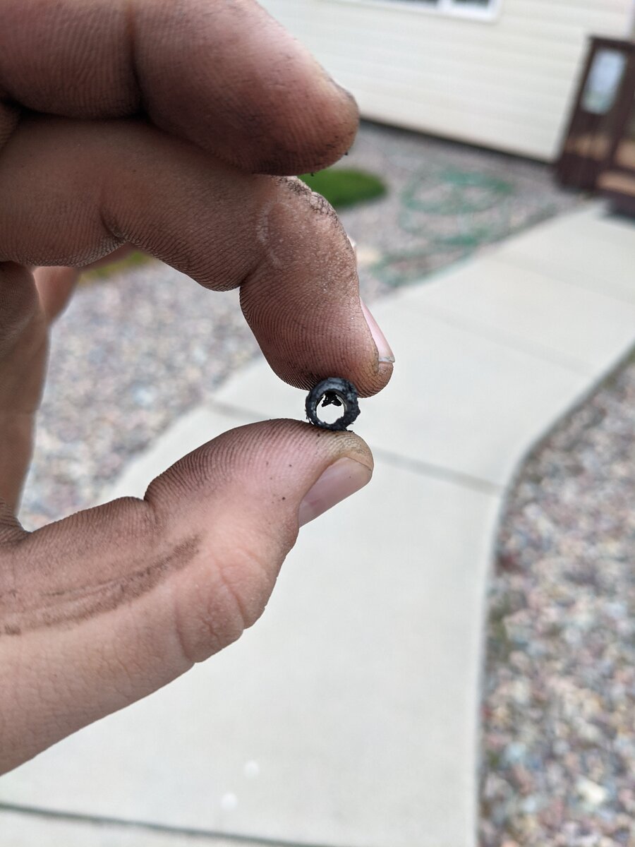

One final note. I couldn't find the oil filter adapter o-ring anywhere, so I took a drive over to the dealership, and while they did not have any, they were able to give me the part number, 87147-S91, and while it is not made any longer, it is still fairly available as it was apparently used in a LOT of diesel engines. So I was able to grab it off ebay for about $8. A lot for an o-ring, but I know its the right one.
