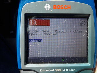

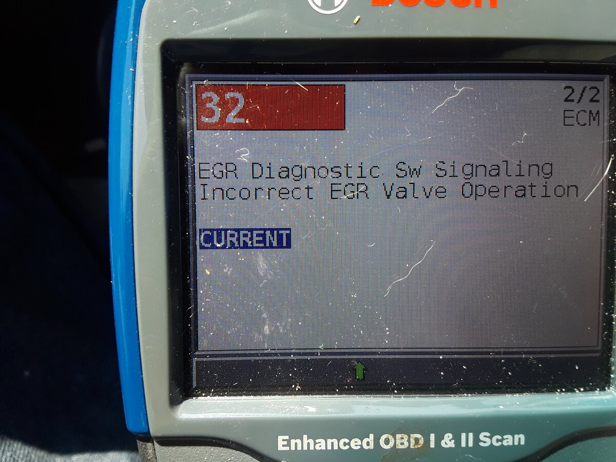

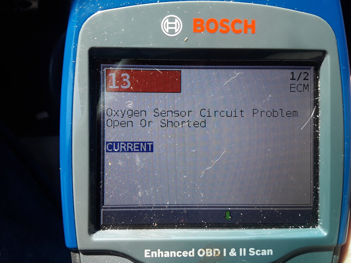

32 and 13, and yeah, TBI, still fuel injectors on it and that threw me off, man I'm still tired 😂
Egr valve issue and 02 sensor circuit issue
Usually with a circuit issue the heater in the hego is fried
Do a visual inspection of the parts and wiring
Check fuses
Likely just needs a new 02 sensor
Which will be in tomorrow, so we'll see, if I still get 32, I'll have to work with that after my camping trip this coming week, should be able to make that 2 hour highway drive there after the O2 sensors at least, I'm sure. And if I can find a decent junkyard driveshaft or find a cheap one that can be in in the next two days. Probably could make it, but I don't want to chance them having issues been that far out. Running 20 mins back and forth to work is one thing.

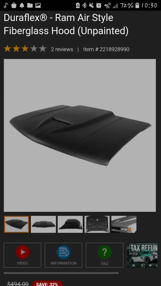

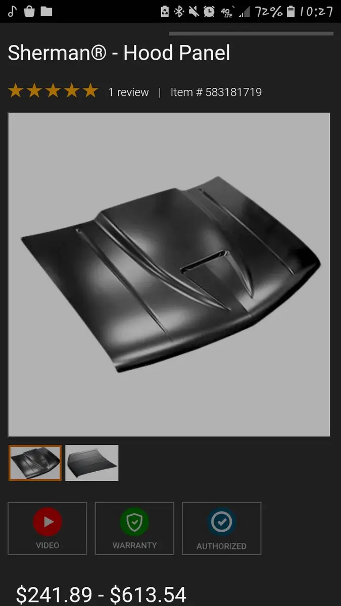

Anyone know how affective a cowl hood like this would be for getting cold air to the engine bay? The center bit isn't open from what I can tell, may see about making it work, with some trx style lights in it as well. But the cowls actually help a bit?

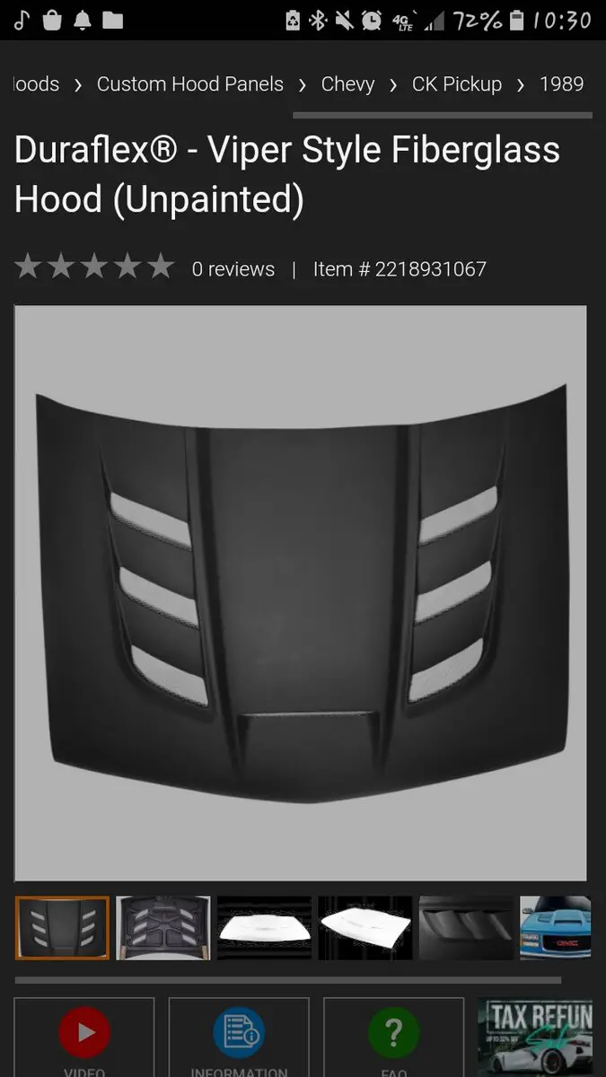

Or I could nab that, middle picture, viper hood, certainly help with air flow 😂

i think the ram hood lets hot air out, less of it taking air in is my understanding, but not sure! the viper one... looks cool ;)
Still helps the hot air issue then! Viper one looka funky to me on the truck 😂
And its fiberglass and would need hood pins, versus the stock replacement ram like one
vents hot air, yep! though not sure its for intaking air, just exhaling (?) :D i still say hood scoop hood schoop hood scoop!
Should still get a bit of cold air through the grille.
Well I can always do the ram hood for the look, cowl and lights, then add vents as well 😂
