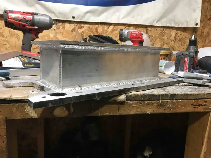

with that said, i went and got the intake mount welded up.

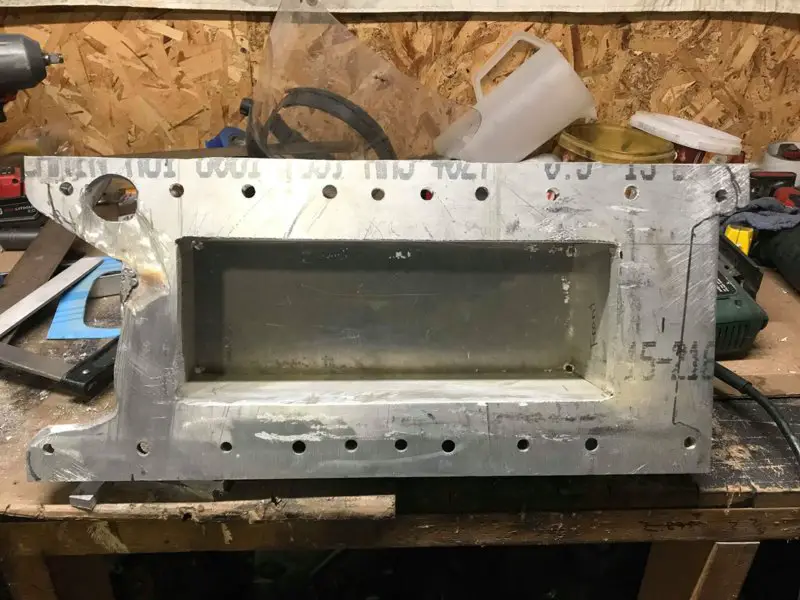

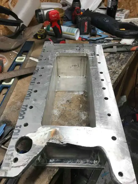

then tonight i started opening everything up, and also probabley wearing a pound of alum shavings in the process

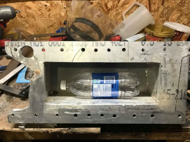

just to give you a idea how big the opening is
and the rest of it
this should also breath a whole lot better then the m112 because some of the front is blocked, and the opening is only around 3 inches wide. this one......

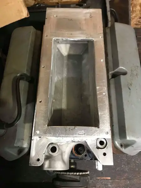

almost all of the port is open
but i did make once again a small screw up. i was going to blow the entire top open when i discovered that the supercharger case gets smaller at the back. i drilled two small holes to guide me where to cut, so i will have to get them welded shut. i did a small change of plans also. i was going to leave it completely open were the relief valve is. i am now only going to cut a hole open with a holesaw big enough for the valve to open. i figure that it will give it more area for the supercharger to sit on, and less chance for the case to distort once its bolted down. also dons fuel rails i used for mock up, i discovered that they are the wrong ones for what he needs, so he generously donated them to me to use. so next weekend if i am not busy, i will mount them or figure out how i am going to mount them, and also do some more filing to the mount to make it look a little nicer and not look like something some guy made in his shed.....like i am doing right now.

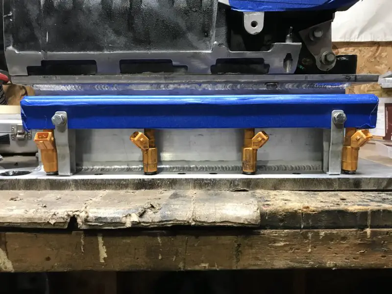

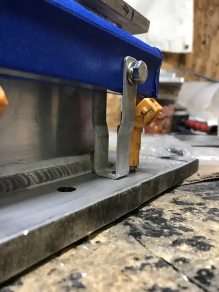

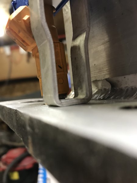

Was busy as hell yesterday, and today was kinda lazy. The only thing I did was fit the rails with the mounts they come with, and whatda ya know! They fit like a glove! I thought I was going to have to get small blocks welded on, but looks like I won’t have to now. I think I will just drill some holes, tap them and call it a day. Will have to use some sealant for them, but I don’t think that will hurt me. My plan is to also use the rails for handles if I even have to take the blower off the truck. I want to have it so the blower, mount, and rails can be lifted off in one shot. For the m112, the few times I have had to pull the intake off, I have always left the rails on and lifted it using them. Granted this is way heavier, but I guess I will see what happens. Hopefully the o rings don’t leak fuel, or game over.

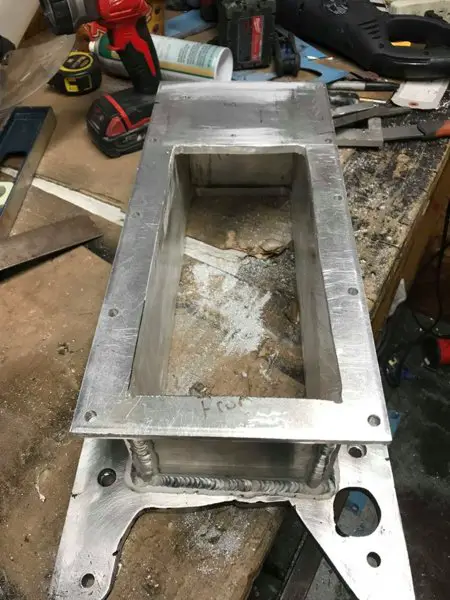

I will also do some more cutting as well. I want to chop that overhang off and make it as flush to the back of the supercharger so I can gain as much space on the backside as I can. It’s still a unknown just how close it’s going to be to the firewall. The m112 I can just fit my fingers behind it, so I believe this will be even tighter

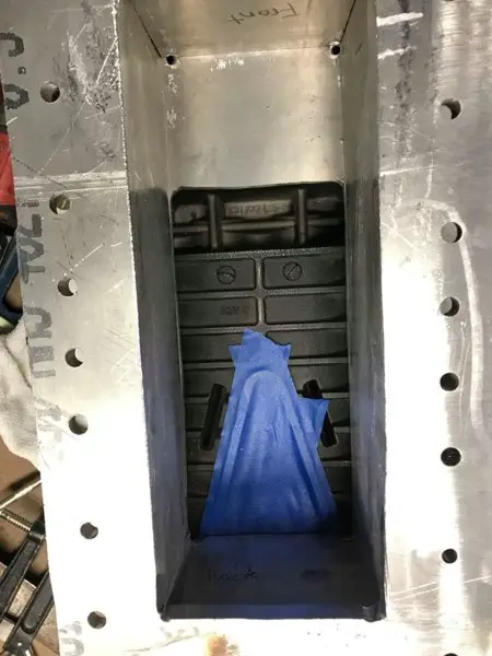

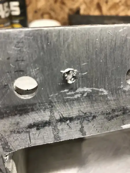

First order was to drill and tap holes for the rails to mount to. Fired up the heater for the gas chamber to let it warm up for about haft a hour. Lined up everything and went to drill the first hole only to find out I can’t drill it straight on and will have to drill it at a small angle due to the overhang. Well ya gotta do what you gotta do and live with it. First hole drilled. Then also discovered that I can’t tap it once again because of the overhang getting in the way. Lightbulb goes off in my head “turn it upside down dummy!”
Perfect I think to myself!
Then the lightbulb shattered when this happen
You know the saying “you’re a broken tap away from it being a 20 min job to a 8 hour ordeal!”? Yea that. Looks like I’m going back inside to watch tv and try to figure out my new problem.
(Runs off screaming into the darkness of night)
Yup, just walk away. some days are like that
Search on youtube for how to remove a broken tap in aluminum, there are many ideas and one will probably work for you.
I just saw one where the part was put in water to boil.
There was also a carbide drill bit that seemed to drill right into the broken tap, and even some chemical ones that dissolved the bit.
When I drilled and tapped my supercharger adaptor plate I used a little oil and only went as far as the tap would start to bind.
After binding started, I unscrewed it and cleaned out the hole with brake clean and compressed air.
Then some oil and run the tap back in until it binds again.
Long process but I never broke a tap.
Small carbide burr or Dremel to eat out the center so you can grab it with something.
not much has happen lately. i did get that tap out however. the upper part is now done as far as i can go until i can lay it in the truck. which gave me a idea last week. evil sits outside and there is no way i am going to mess with it being this cold and no garage. BUT, dono's truck sits with no motor right now, and in a garage. he gave me the thumbs up to dunk the mock up block (which happens to be his old stroker block so it can say its final goodbye to his truck) and heads into his truck, then put the new mount and blower into his truck to see how everything is going to fit. this also means i would have to bring the block, mount, supercharger, and motor picker to his place. couldnt do it last weekend, its way to cold this weekend, and he wont be able to help in the next 2 weeks either.
