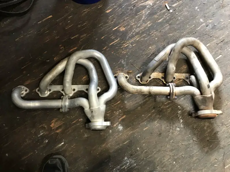

This weekend was get most of the crap that both of my trucks have annoyed me with all fall and into the winter. First up evil. Towards the end of fall I could hear a exhaust tick on the drivers side. Pulled everything apart but couldn’t get the header out. I’ve been able to do this before on the drivers side without taking everything apart including taking the header apart. This time no dice. However when I pulled the header back the gasket looked ok. Fingers crossed new gasket went in (old and new are remflex, start it up......tick tick tick tick..... when I stuck my head into the wheel well I happen to see a strand of fiber on the shifter cable floating around. Put a flash light in and saw a very small crack on the header. Dono to the rescue. He happen to have a drivers side header and let me use it
. However after pulling the header out (unbolting the front dress and some carefull and forceful manoeuvring this time thanks again Dono) I cant see it now. That’s frustrating.... I have now however found a new way of getting blend door actuators out of Rangers. It does involve a saws all but that’s a different story for a different day
