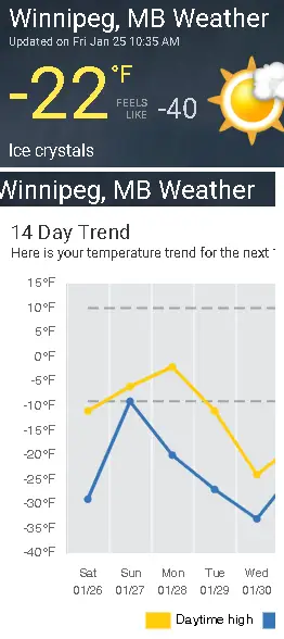

It is a cold one this year. We aren't that cold though. Wednesday and Thursday this week are highs of around -1 F.
I'm not greedy about that snow stuff...
You can have mine!

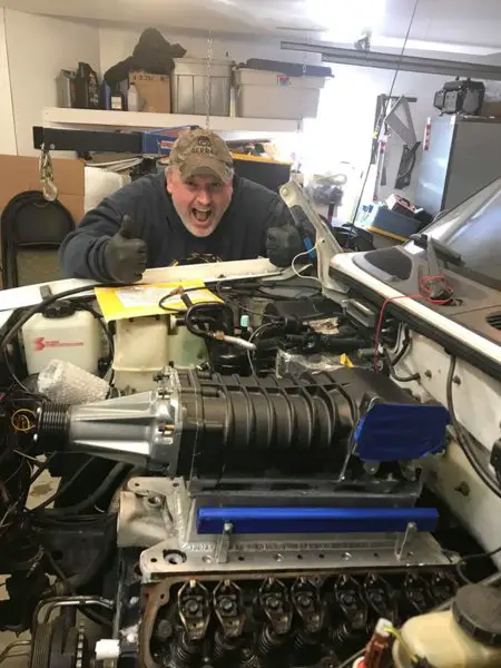

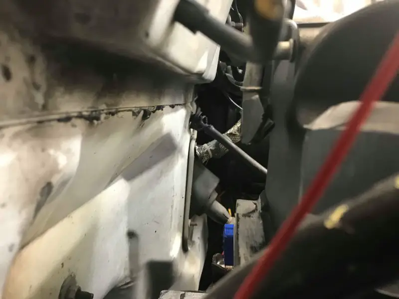

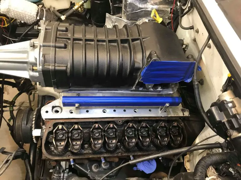

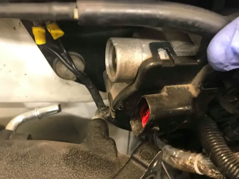

mmmmmmmkay. so. today was the moment i was dreading. dono went away on a nice warm tropic vacation and got back (that isnt the moment i was dreading btw) while up here we all froze to the point more then the balls fell off the brass monkey. he got back a couple of days ago and i was going to use his truck to see how well (or bad) the blower would fit because his motor is out and it would be easy to put my mock up block (his old block) in and drop the blower on to see what i would have to cut, hammer or "massage" to make everything work.
well.....

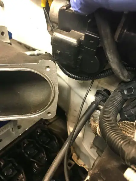

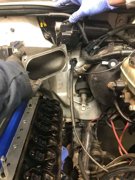

as unbeleiveable as it sounds, fit with zero clearance problems! i didnt even think i would be able to use the intake elbow that came with it, but with a small amount of cutting, it will slid in like a glove! so here are some pics

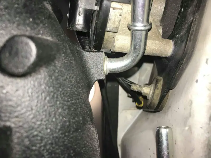

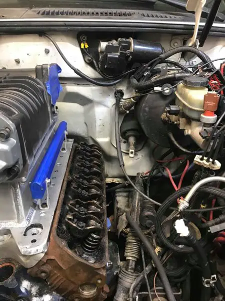

one of the vacuum ports hits the windshield wiper motor, but that can be cut, filed and closed with a frost plug

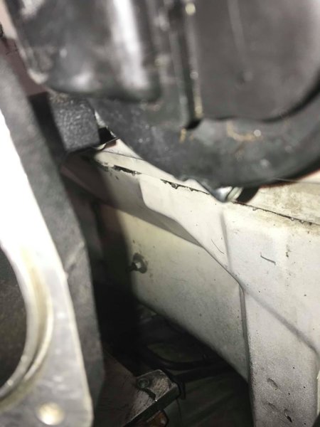

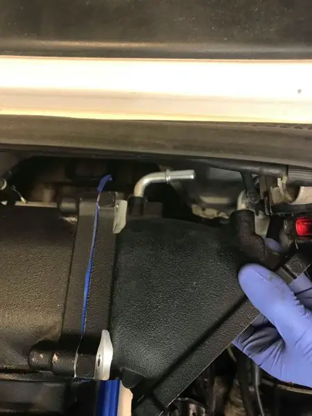

bottom side looking up at the elbow

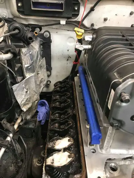

back of the blower to the fire wall. with my m112, i can barely get my fingers in behind it
there is way more room them what i expected. as well as there is plenty of clearance for the hood as well. i thought i was going to have way more issues then this to the point i said to don that i am a little worried because all this is being built for a truck that earned its name, and it is being built using a motor that has a black cloud over it. i wasnt going to use the stock intake elbow at first, but i am now, and will have to wait until everything is in the truck to build off it. granted no wiring was on, but you can move that around. as well as i knew i would have to change the fuel lines and some other things, but this really surprised me just how nice it dropped in. don and i put the valley pan on the motor first, then laid the mount, supercharger and rails down in one shot which was what i was hoping for. i am also going to have to get some studs for where the intake bolts to the heads. the rails wont allow you to put the correct length bolts in an have to be shorter. also with studs in there, you cant miss when you drop it all down.
so i am a pretty dam happy camper at the moment, thats for sure. thanks again don for letting me use your truck for this!

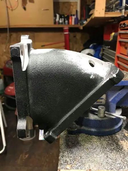

we are now headed out of "its so cold i saw a polar bear wearing a sweater" weather now. i headed to the gas chamber and did the elbow tonight. forgot to get some before pictures. wanted to get in and out of there as fast as i could with causing minimal brain damage
that should solve the clearance problem Clarence.
