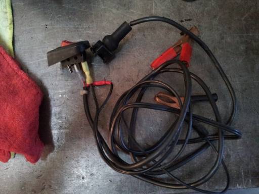

I pulled the upper intake off and tested the injectors with a tester I made. They all worked fine. Then I pulled the valve covers and checked all the springs, rockers and pushrods and they were all fine too. So I'm going to put it all back together and see how it runs after tuning.
Here's the tester.
