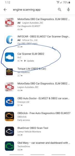

Buy a elm327 obd2 reader. It'll give you real time readouts. I like my Vgate. Around 10-12 bucks on Amazon. Then download a free app. I like Car Scanner.
