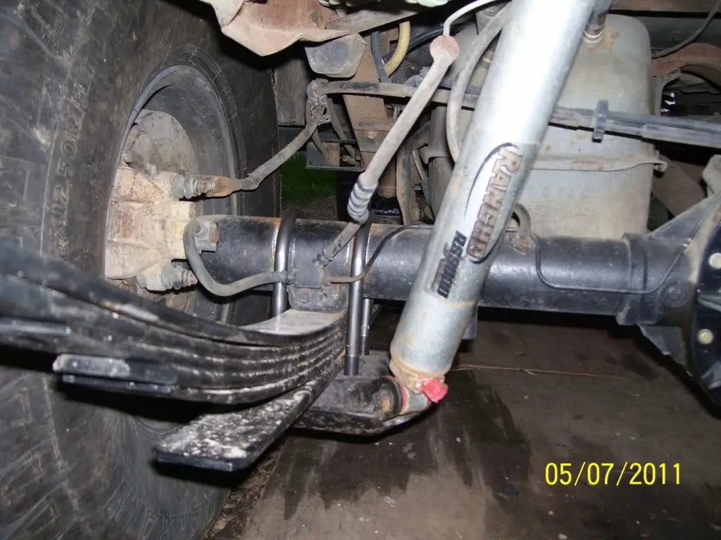

After installing the F-150 leaf packs and having 7 leafs in each, they are a lot taller and the stock U-bolts were just to short for my liking. I wanted some BEEF to replace them. After looking around the interweb thingy, I got an idea of the costs of larger U-bolts. I then called the guy that I talked to about the leaf packs, and he told me to come by and he would take care of me.
Glad I listened to him :) He made me a custom set of grade 8 U-bolts to my specs for the rig. 5/8" x 3.5" x 8" plus 24mm grade 8 deep nuts and double thick washers for less than anything I found on the webs. :bounce:
Alright so today was the day to tackle this simple bolt on Mod...(so I thought :rolleyes:)

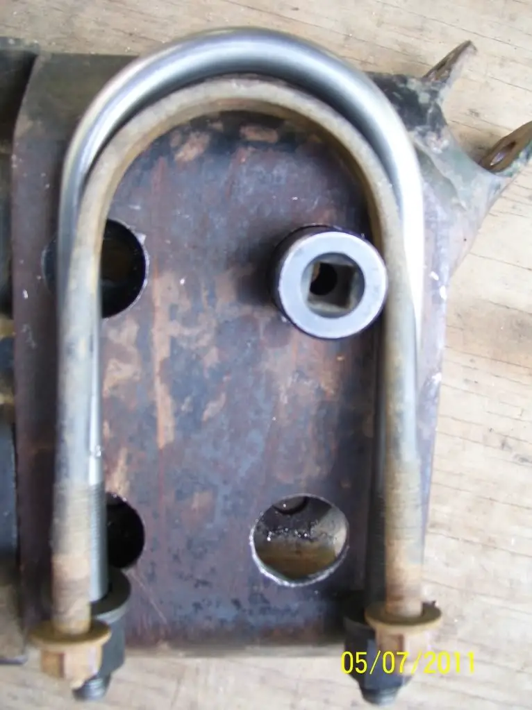

The 1/4" skids I have (made by boogerwelds) have always been one of the coolest things on this rig to me, up until today :( These made this mod a royal PITA! You have to drill out the plates for the bigger U-bolts, no biggie right? Nope, major biggie. The skids have large holes to get an 18 mm deepwell socket in, I needed holes large enough to accommodate a 24mm socket. Let me tell you, this wasn't an easy thing to enlarge 1/4" plate with 1-3/8" already in them. A 1" drill bit was the largest I owned, and I needed a 1.5" deming bit for the drill press. ACK! Look some up online for pricing...wow!
Anyways, I got the guy who helped me with the bumper fab work to pitch in a hand and save the day. He used a BURR bit with a 13 HP gas powered compressor to power a die grinder and enlarged the holes in no time. Woot!
After fighting the axle and having to run down a thin wall 24mm deepwell socket, I got it installed.
Here is the old stock U-bolt, the new HD U-bolt, the plates with the enlarged holes and a 24mm socket to show why the hole has to be so big on these things.
Installed and ready to tear stuff up.
For any of you that want to upgrade to a 5/8" U-bolt set up, remember when you drill out the larger holes to also go to the outside another 3/8" to accommodate the larger bolt thickness. Otherwise they won't fit. The width of the leafs (2.5") and the stock hole centers are made so the stock bolts are snug to the sides of the leafs.

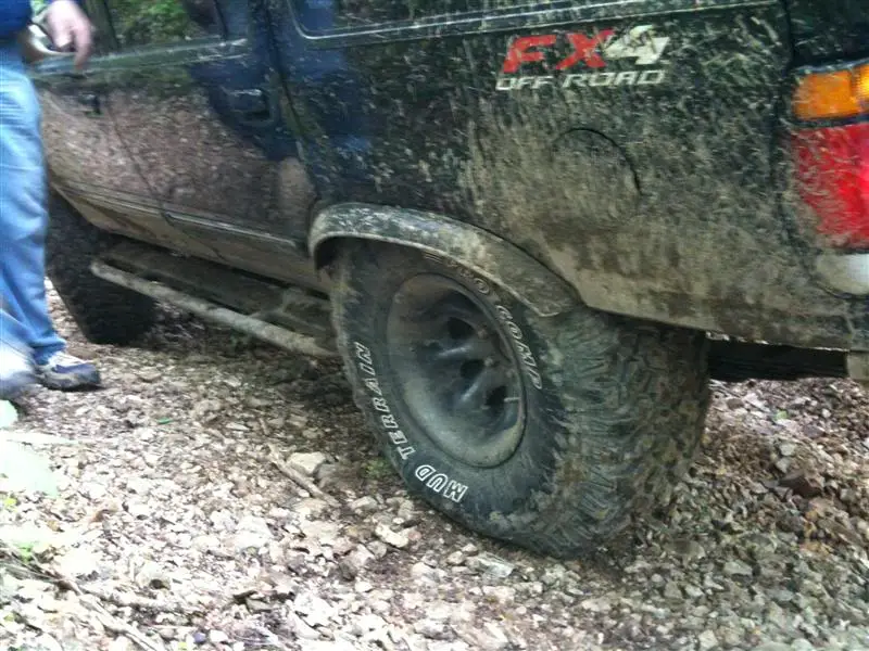

The rig got a little mud on it this weekend. The front locker was a nice addition to it. The 35's might be just a tad too much for the 4.56 gears tho. I was stuffing them meats pretty easy and rubbing the fender flares everywhere on the trails.
