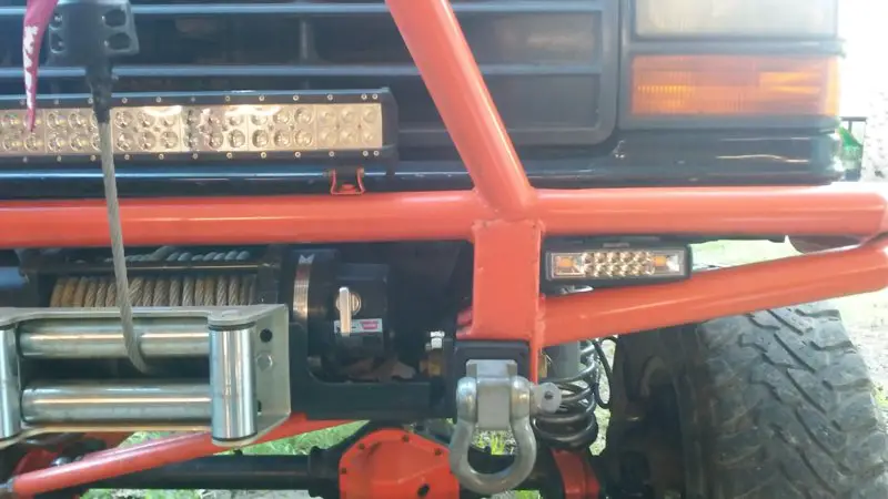

And built the little bracket for the White and amber Olympus Off-Road First Responder pod lights. The outside amber lights flash in different patterns and the center is just a white beam.
The mounting bolts are just hand tight right now so they are a little crooked. Pulled the little L-brackets off and painted them.

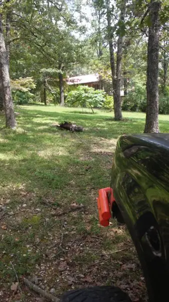

But on a good note, the winch did put in a little bit of work this weekend.
Got tired of mowing around that stupid stump that was rotted out really bad and just pulled it out.

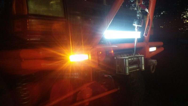

Finally got my white LEDs wired up.
Still need to find my micro switch for the Amber first responder LEDs. They are just jumped right now.
The Amber lights will run independently from the white. They have three functions sold, flashers and alternating flashing.

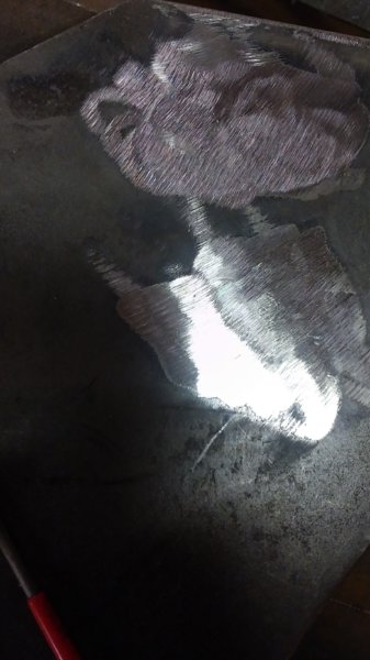

Not much work done Tonight but I got the holes welded up on the 3/8 bumper plates. Going to line them back up tomorrow and try again lol

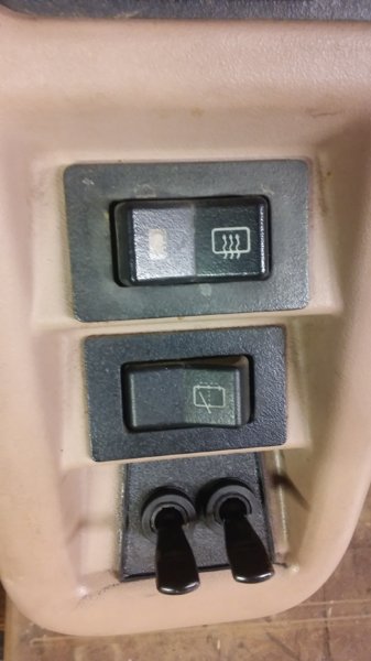

And the new switches for the LEDs mounted. Doesn't look too bad.

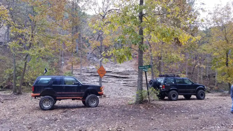

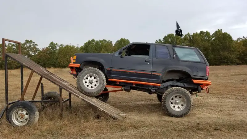

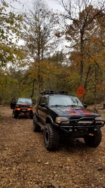

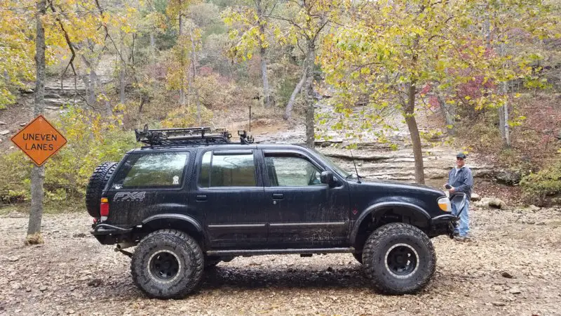

Finally got the Black Pearl on the trail this last weekend. Myself, Gman and my son Landon spent the weekend at Southern Missouri Off-Road Ranch (SMORR)
I had put my rig on the toy hauler to trap it down and one of the E-Trax for the front tire straps pulled out from a small section of rotted wood... TWO MINUTES before @gmanpaint showed up! :angryfire::banghead:
I thought i had it planned perfectly to be damn near ready to go by the time he got to my house.
Well after we replaced that section of wood, we decided to to grease the joints on gmans rig, and found busted passenger CV boots so i decided to bring his rig to my dealership and swap the shafts due to having a lift and tons of tools available.. Well i wasnt thinking about the no outside work at the shop without a repair Order at my dealer, and just got my butt chewed for it from the boss. MY FAULT! I was only thinking about getting on the road, and every minute counted at the time.

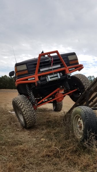

Finally gassed up and on the road at sunset (we were planning on leaving at 1400), snapped a pic of gman outrunning me with the 5.0. Got the camp setup in the dark and at first light after camp details and breakfast we made our way to the RTI ramp (approx 30*)

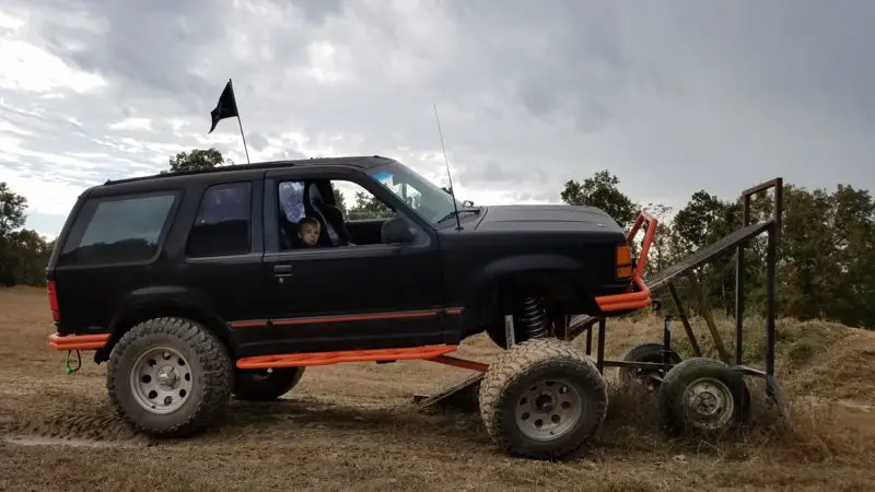

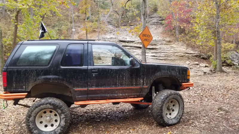

52 inches i think is pretty respectable for all the "thats good enough" work thats been done to the rig.
We are pretty sure that my shocks are now the limiting factor with the new heep 241 PPI coils on the front. We sat at the RTI ramp for a bit checking things out and making metal notes on where to permanently mount steel and rubber brake lines, figuring out limit straps and all that minor detail stuff.

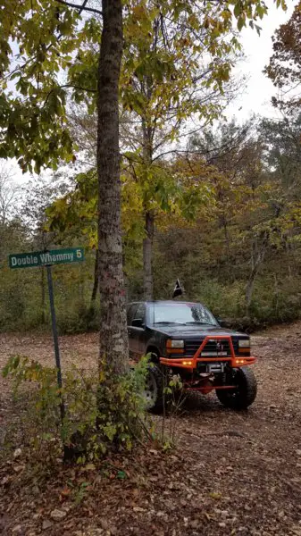

My navigator trying to make heads and tails of where we were at!
We headed to some level 2 and 3 trails for the day of wheeling.

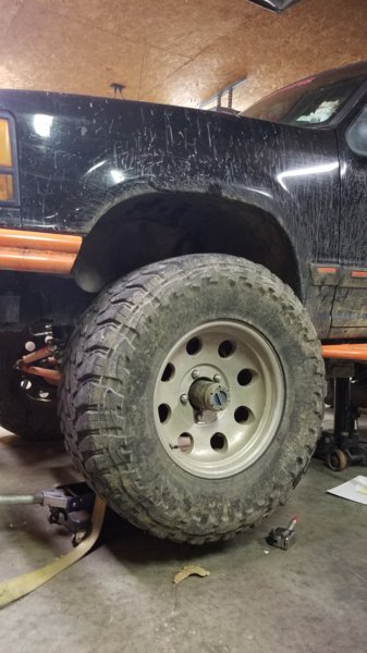

Back at it monday night, with the direction of gman.
Removed the front shocks, extended and compressed the front suspension to measure for new, longer shocks.
I did not snap a picture of it at full droop cause my forklift jack (you can see in under the radius arm cross member in the picture) leaks down at a steady rate.
That is about full compression, i have about a finger and a half width before the top of the Diff hits the engine cross member.
compressed i am sitting at 18.00 inches OC
extended i am sitting at 27.50 inches OC
so a 28+ extended, 17 compressed shock should do well i believe.
