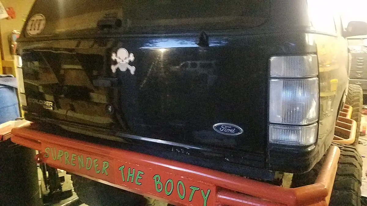

Whoo hoo early Christmas for me!! I have searched long and hard for a set of these. I saw a picture of them on a black 1gen almost 10 years ago and have been searching for them ever since, and a set popped up for sale so I grabbed them. These will be my favorite mod to date!
The guy had a SPARE set laying around
man oh man those are getting rare!
Do yourself a favor and put a light bead of clear silicon around the edges where the clear lenses meet the plastic backing....they will last alot longer if you do this!
Wicked cool finds. triple shifter, yukon zip lock, and clear tails!!
Keep water out?
yes moisture the aftermarket lights are sealed with inferior glue to OEM
Guess I'll have to use some ford stuff from my dealership lol

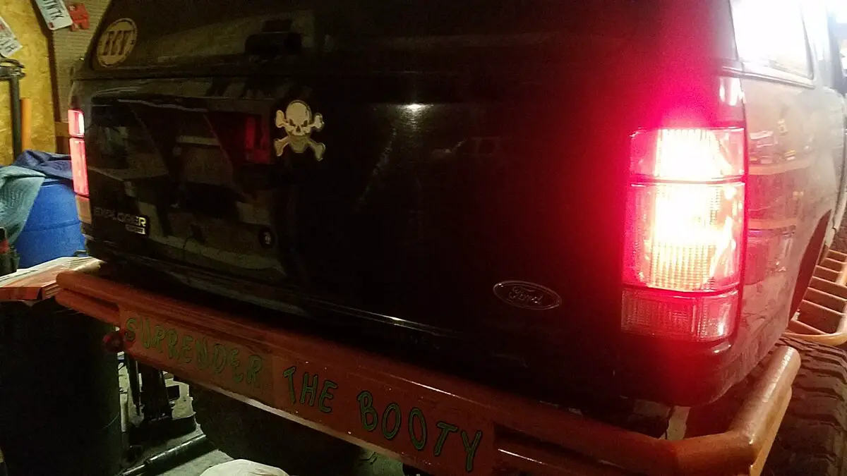

Tail lights came in!!!!
With the red LED brake/turn bulbs.
