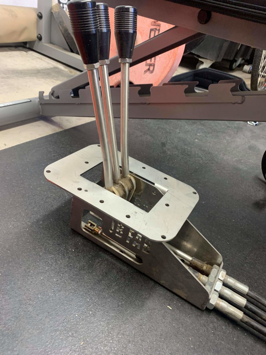

This one kinda goes along with the LS swap since i am running a th400 and NP241. The 241 is just going to get my by for now til i switch out the the NorthWest FabWorks EcoBox and ford NP205. I set of JB fab triple sticks.
f
For now i am just going to remove two of the sticks and run one for the 241. Figure out where i want the single stick to sit and then trim up some spacer bushings to capture it in place.
