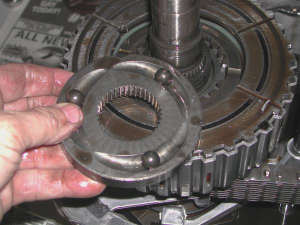

I just disassemble my transfer case and I have a question, can you help me?
The number 01 is locked in number 02, this is right? Or the number 01 should work moving into the number 02?
The teeth on my part (02) are very worn and locking the piece (01) and do not know if I should buy another piece.
Thanks
The new part arrived and it is not welded, but it is locked.
It has an ink mark defining the right spot to lock the two parts.
I will install and post the result.
