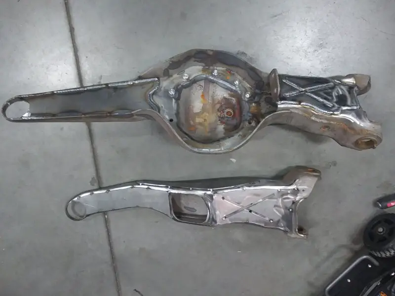

Finally got going on the TTB! She gained a little weight.

very nice. Did you order the plates/truss or build them
Going with uniball pivots? Not moving the lower ball joint?
Going to be one wicked truck!
Micah J
July 5, 2016
106
63
AZ
1994 Exploder
I'm stoked! We ordered the files online and cut them on the lazer at work. Yes uniball pivots. Havent decided on lift yet so not cutting the BJ yet. Really need to source the billet lower. Going to be doing 2 more sets for my buddies and building engine cages.

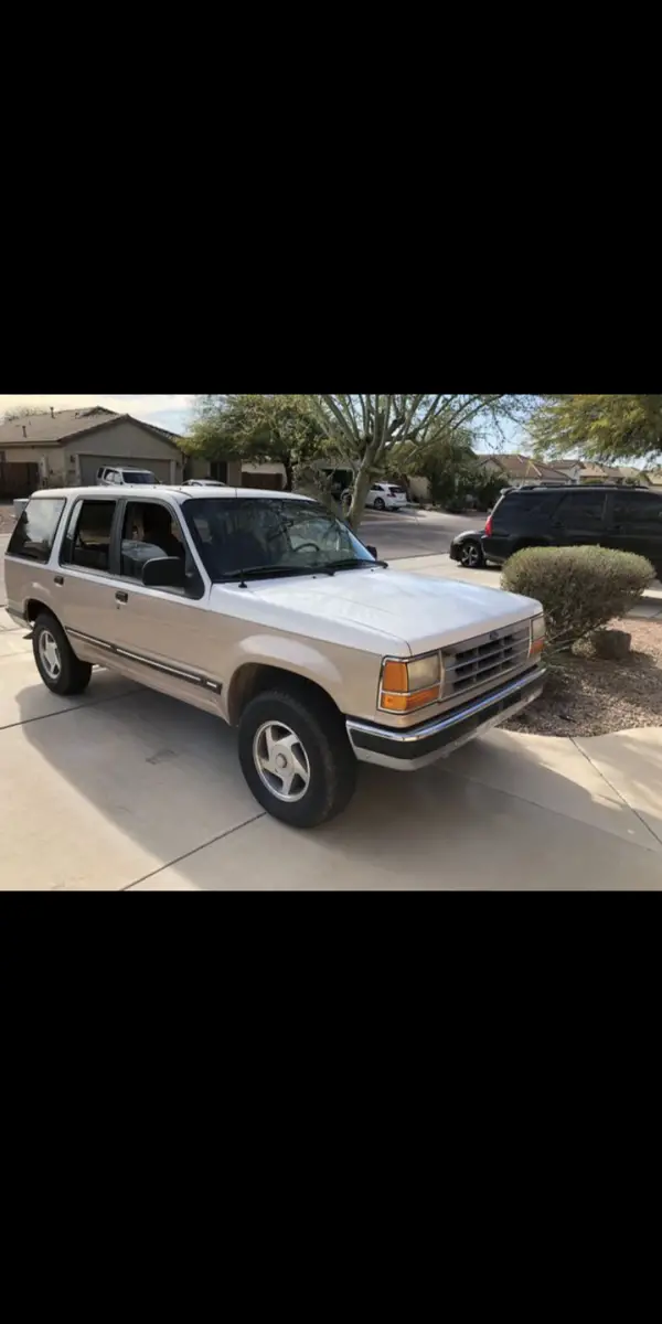

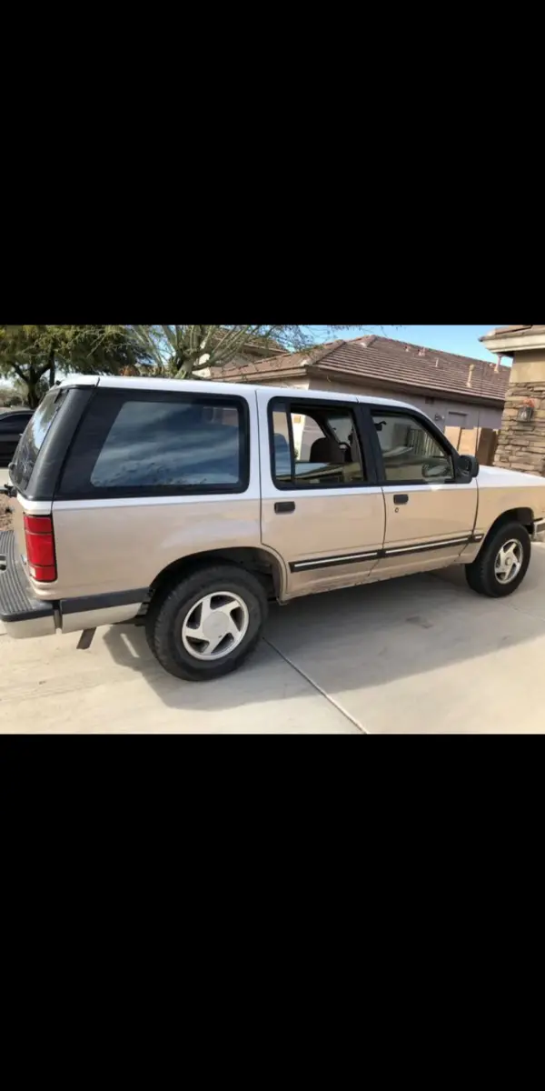

Me being me, I was itching to get back out wheeling so this was purchased. In fantastic condition for the price. Push button 4x4 even works! Just had to find a front shaft! Still not sure why it was missing.... Thank you President Trump

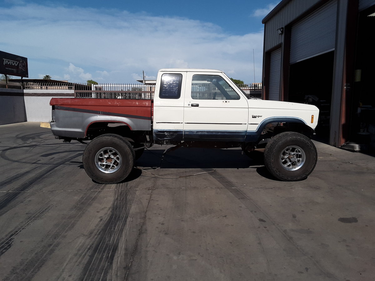

Whole lot of work later we have an extended wheel base and part of a bed. Finally looking like a truck! Wheelbase looks to be about 122"
