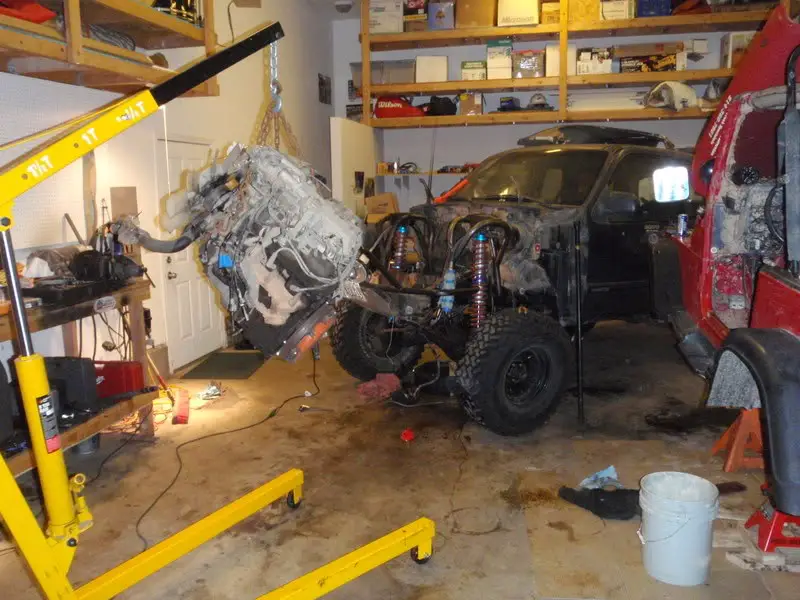

Well we got the motor pulled on Friday night, and I pulled the gas tank today in preparation for the fuel cell and cage. FYI, make sure you drain the gas tank as best as you can before dropping it. I chose to ignore Mr. Haynes manual and doused myself in gasoline and spilled a ton in the shop. Coulda been pretty bad if I was still a smoker!!:eek: As soon as I'm not broke anymore we are going to pick up the 350 block and heads from the JY then start building it up!:D

Oh and we hauled the old motor to the junker today so no more pinging motor and total lack of power!

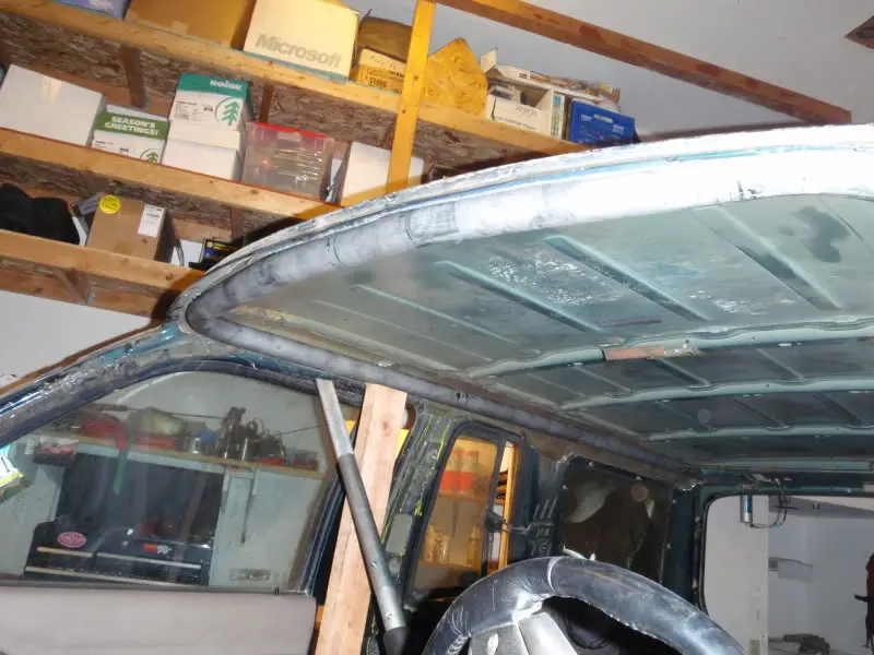

First we got the bender mounted, and I finished cutting out the sheetmetal inside where the cage is going, then we got the windshield out...

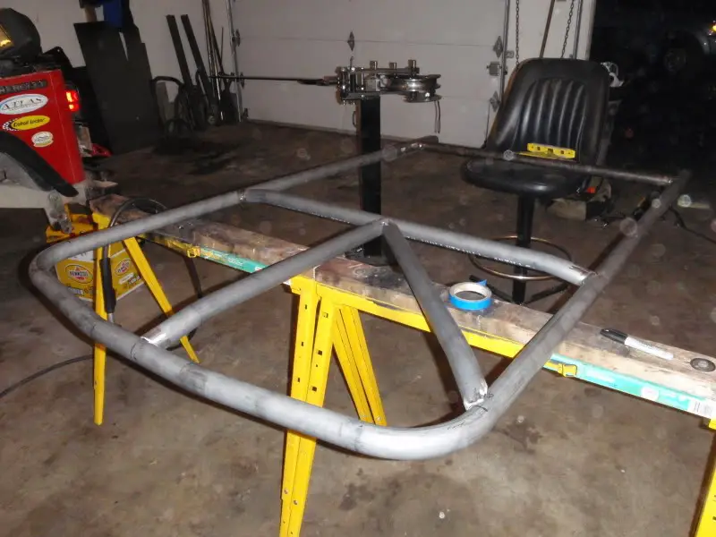

Next i got the main halo bent up...
Fit was nice and tight. (it will be level and not tilted up in the back don't worry)
Then I put the rear crossbar in, and the tube that connects the B-pillars.
