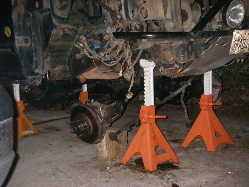

Well I got the motor crossmember bent back into submission(still need to gusset). Found out that the passenger side beam I made was messed up so we grabbed another from the junkyard and I got that finished up yesterday. The rotors and bearings got all cleaned up and the beams thrown on the truck. Started on the radius arms a little bit so that is next up!
Truck with beams patiently waiting for radius arms

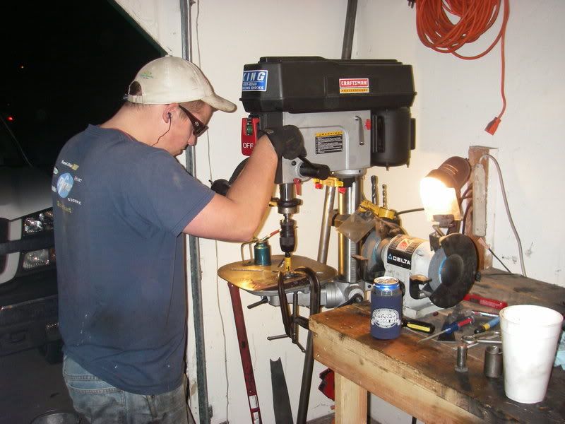

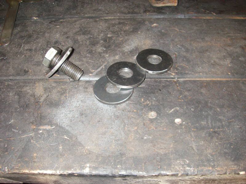

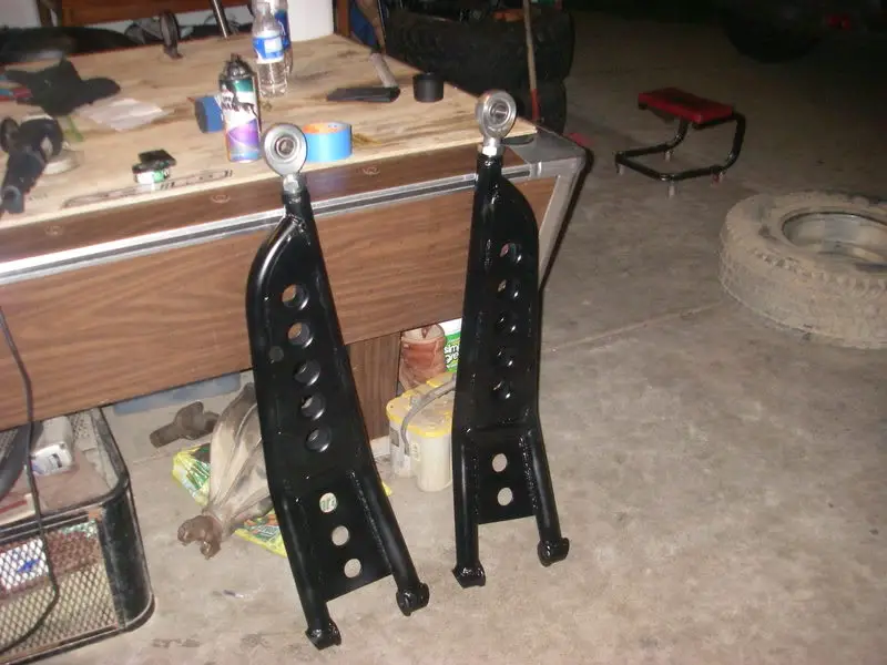

Rare spy pic of the 3/16" plates welded in...
Before
After some lovin on Johhny's press with a dimple die:D
They should turn out pretty nice when I can find some time to weld the suckers up;)
And before anybody says anything about one arm having two holes in the bottom plate and one having three, the one with two had to be shorter to clear the pumpkin junk on the driver's side;) Real busy this week but I should be able to get these suckers done and mounted on Friday.
Thanks for the help with the dimples and the torches Johnny, you're a life saver:chug:

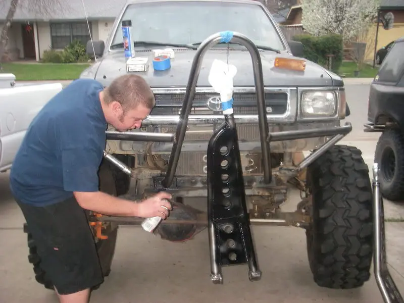

Well I guess all you EF dudes are only into SAS swaps but I will still continue to post my desert junk in here in hopes of inspiring someone to build up D35 prerunners;)
Here ya go Johnny, Marc's triple EXXXtreme bumper works great as a paint booth...
another
