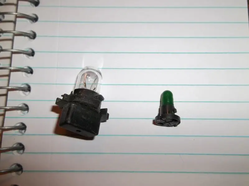

Does anyone know which size the tiny bulbs for the message center are?
It is a filament bulb.
It has a removable green "condom" ( for lack of better term)
Here it is next to a 194 socket bulb from an instrument cluster.( 194 on left, Unknown on right)
looks like the same size as what's used in the rear defogger button and for the driving lights button. T4's i believe. a good source for these bulbs is www.autoillunination.com but without the "mouse condom" the green bulbs don't look green. sometimes you can get the mouse condom off without tearing it and sometimes not.
It has a removable green "condom II" ( for lack of better term)
Its a T type bulb, off hand don't remember the the number 4 or 5.
The green "condom" will come apart. I brought new condom, they come in different colors. I purchase either from Pelham or
digKey. I believe I just get the bulb less the base. I would have too look for the information.
To remove the condom you can try, put them into warm water too soften them first.
