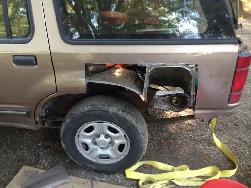

For now the front end body work on the inner fenders is done. So I moved to the rear. Now up to this point I havent mentioned the overall plan, I'm still going with coilovers and go fast goodies but I will not be keeping the dana 35 when its all done. ;) SO I'm going to put a dana 44 under there. Now I know what you're saying this is the TTB Terror not sexy sas! Well you're right, Its getting the dana44 TTB more to come on that later. However with all that said I will be going full width rear as well so fiberglass fenders are now a must.
I always said if I was going to run them I would keep them weather proof, removable, and not keep the factory wheel wells under them. So in order to do this I had to make some custom "inner fenders" on the rear. I pictured it like a pickup with the bed skins off, this way I can remove the fenders and door skins, still be weather proof and not worry about the fenders on the trail. I would like to build a carrier in the back to hold the front/rear fenders and door skins when not in use but I'll have to see how much buldge is needed to cover the f-150 axle. If I'm going to have to run 7in rears and 6in fronts it might get tight? :dunno:
So off it comes!
and I started to fill it back in finally...
I just got that piece tacked in before I decided I should drop the tank to prevent using my last extinguisher. :fire: :hammer:
I am pretty proud that I dropped 2 tanks in 3 hours. Got the one out of my 94 for the new fuel pump, and dropped the 92 (one I'm working on). Not sure if I want to try to swap tanks completely or see if I can pull the pump out of the 92 without damaging the lockring :dunno:
