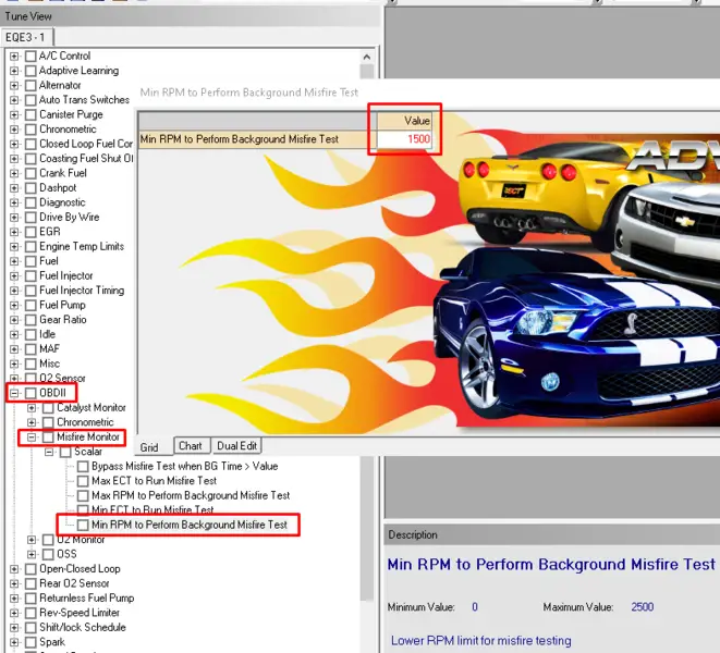

So, I was never actually able to get rid of that random misfire code p0300. Fuel trims looked the same on both banks, and tried everything I could think of except for inviting a priest over for an exorcism.
I am quite certain its the cam causing the issue. The fix? I told the pcm to avoid misfire checking below 1500 rpm. Problem solved. Iv'e been driving off and on for the last 6 or so weeks with no check engine light on.

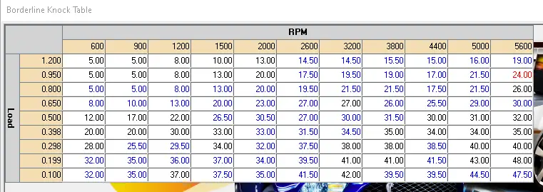

The tuning never stops. I tried getting more mid range by adding more timing in the lower rpm's, but the J&S knock sensor told me otherwise :( . The cam card says to use a minimum 3000 rpm stall converter, and I am going to say they were not lying. My 2800 stalls to fast for a super quick off the line launch. One word....shitty.

For whatever reason, I seem to be able to add quite a bit of timing above 5600rpm. I'm still playing with that number, slowly inching up up to where the knock sensor lights up and tells me to back off. I think the water/meth is letting me do this. But, notice what my timing table looks like. At peak torque, I don't have much timing. Also, look at the lower rpm's. I thought some of the area's that the knock sensor was detecting detonation was a false reading, but I remove a bit of timing and the sensor doesn't detect knock in that area anymore. How do you argue with that?

I'm still learning also. It's by trial and error, but at least I know what detonation sounds like, and I have an aftermarket knock sensor that tells me when the timing is too far advanced even when I can't hear anything. In your case, you wouldn't be after more timing, as max torque occurs without max timing.
