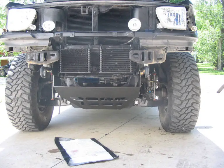

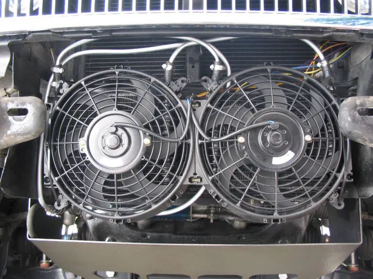

I am attempting to address the transmission heat issues--
coolers installed
Then I installed 10" fans
Wiring the controller took a while, as it opened a can of wiring worms
Then the bumper. I am having a bit of difficulty getting it where I want it, as the tow hooks are just in the way. I am going to adjust them. This is where it is tonight. Not quite done yet.

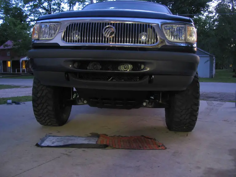

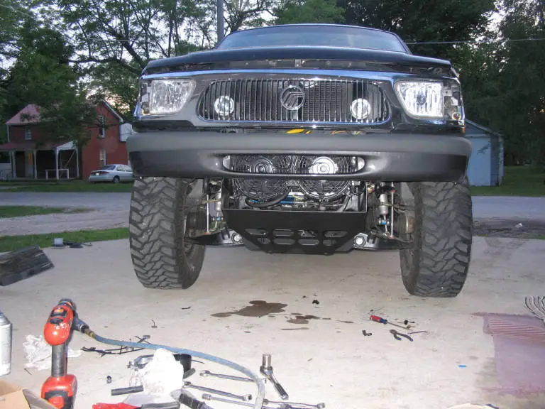

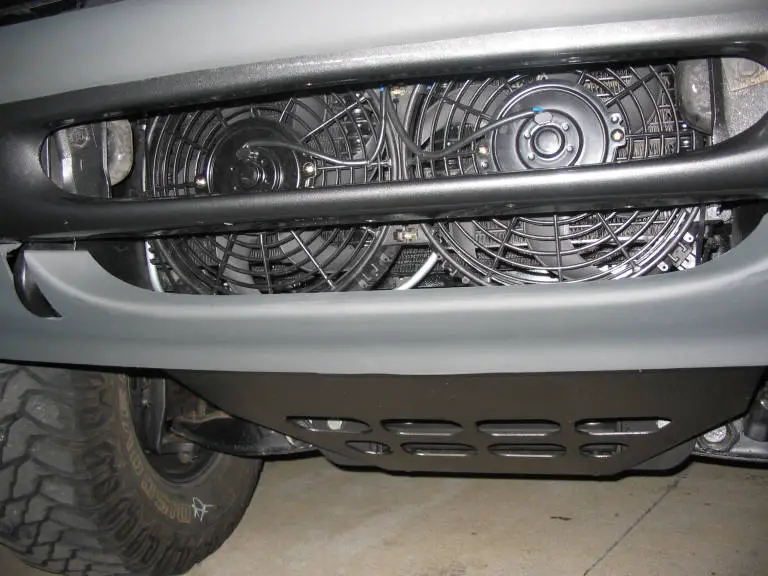

Trans cooler-bumper replacement is just about complete!!
Here is a close up of the fans behind the bumper

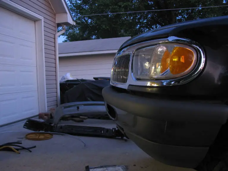

As for the bumper-it was pretty dented. I used jb weld to fill, over and over until it was filled in well, then sanded the whole thing with 80 grit. It was then washed real good, allowed to dry, heated to 325 and shot with Smoked chrome powder, then baked to 390 for 2o minutes. It then was cooled and I shot it with mirror clear, and rebaked for another 20 minutes

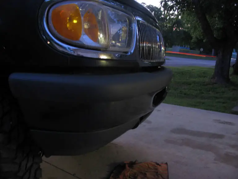

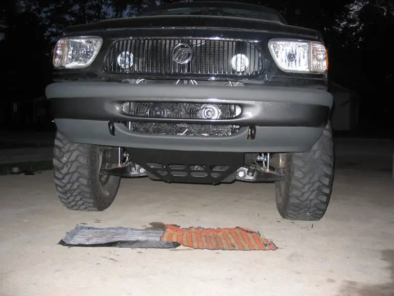

Here is detail --driver side
Passenger side

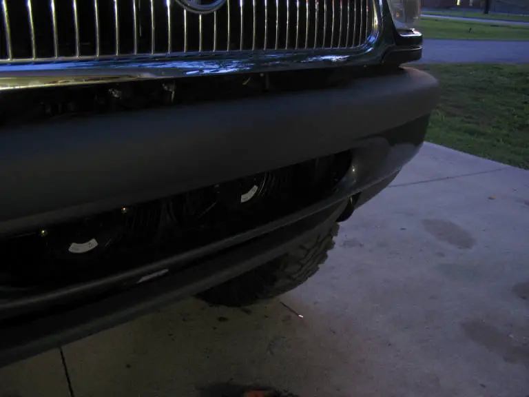

Center
Front, from a low angle
with flash on
Eye level front

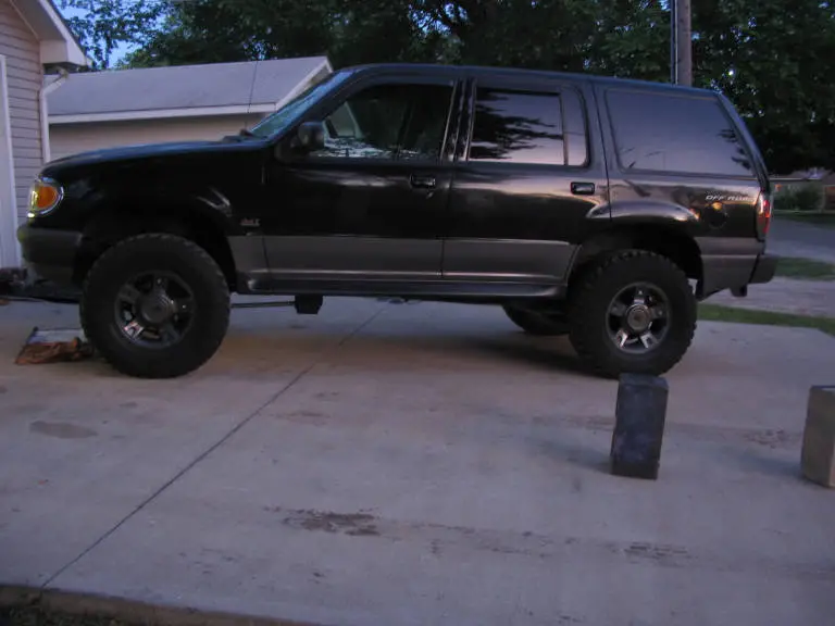

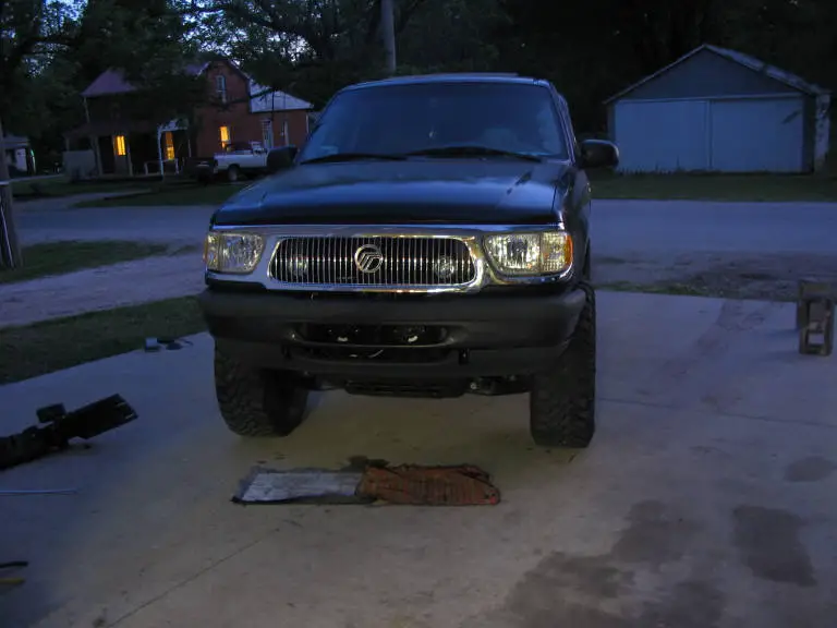

And a side shot, just to show I finally have matching bumpers and plastics
I think the side now needs a darker gray, and it will look half way decent then.
