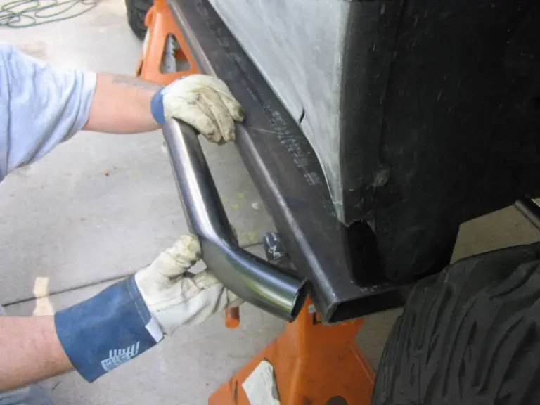

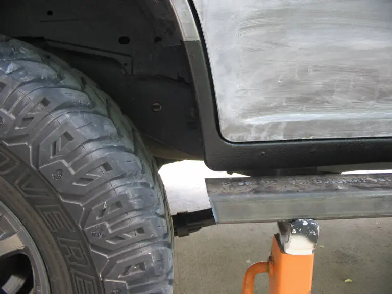

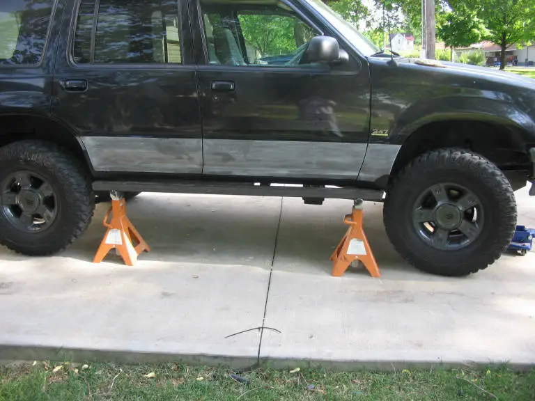

Well guys--I have done it now
This one is full on commitment to off roading, and no turning back. Up to this point, the changes to the truck could have been "undone"
Today I flattened the rocker seams, to make room for rock sliders.

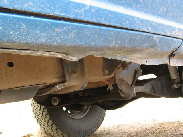

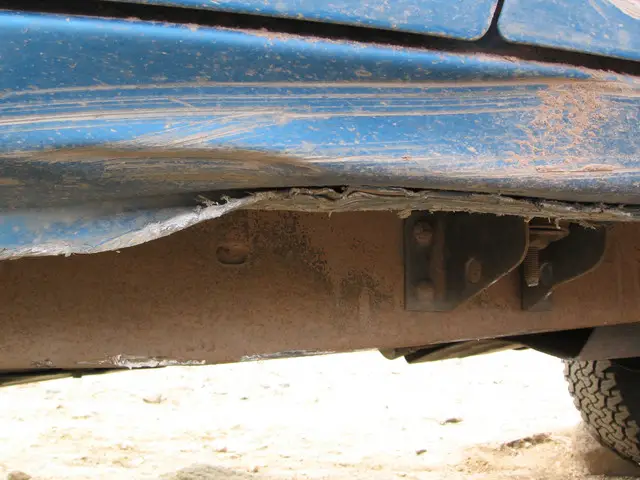

Did you make em purdy or do they look like these? :D
Well, it isn't "purdy" but I think I did a better job that that. Once it has hercliner on it I will get pics
Ideas for bending over the fender tabs please? also, how about filling in the front 2 holes?
I used touch foam to fill the rocker holes, and was thinking of using some plastic push pin buttons for the front 2 holes, sticking them in with the first coat of herculiner, using it as glue--then coating over them with the second coat.
My real hang up now is how to roll the fender tab over--
OH NICE!! Way to do it now before nature does it for you! :)
explorer's get hung up on the rocker and also the rear leaf spring hanger (front mount, its under the frame = the big suck) this happens on the break over angle, sliders are a HUGE help for pivoting on rocks and cresting a climb..... perhaps after you may come up with some sort of slider for the rear spring hanger :) I would be using cutting board material myself!
Cant wait to see what you come up with now Jon :) PC on sliders = lots of touching up! Unless you could make a replaceable skid plate out of the cutting board stuff... my BII will have skid pads all over the place, slides nice on slick rock

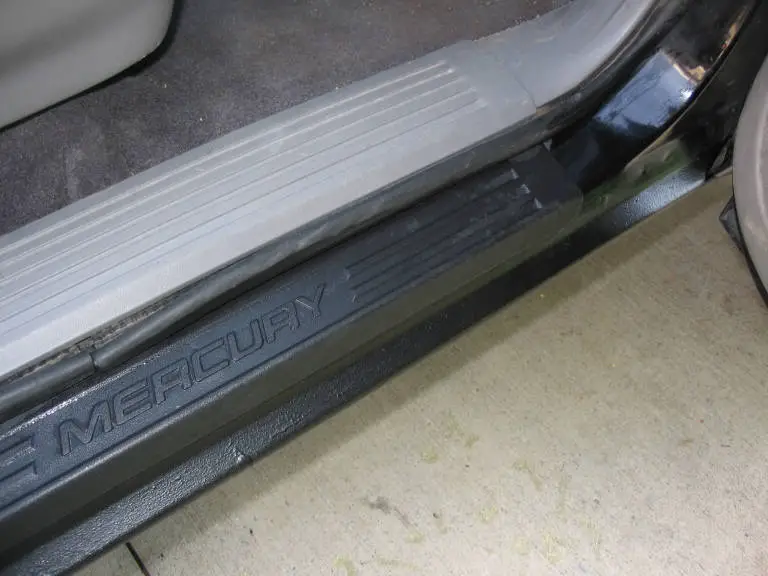

Sanding sanding sanding--
Yes I have been sanding on the lower silver --it's going darker-
Nevermind that now, what we want to see is the herculiner. It will be painted over

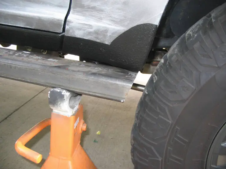

side shot
I had some kinda stone gaurd on mine, so I followed those lines--

Middle door jamb
front door jamb
Are you going to take the doors off to PC? or are you going to just paint them? rock Rails look sick. you'll be able to take on the big'uns with em.
can't wait to see them done
