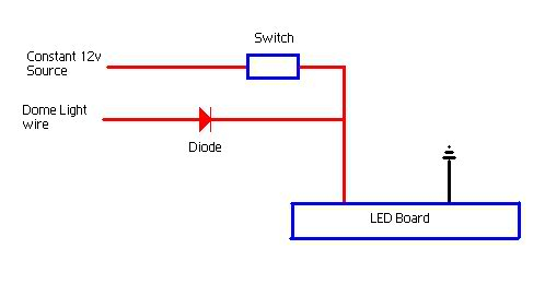

What do you mean by Diode?
Im working on figuring a way to wire them in right now
And I think I got it all figured out, other than which wire is for the door ajar lights
And would using the Ashtray light as a power supply work?
A diode only allows electrical current to flow in one dirrection. It keeps one circuit from "backfeeding" another.
Ashtray light would be a "constant 12V power source" when the headlights/parking lights were on.
The only one I ever bought was at Radio Shack for a headlight harness. I think they are rated on volts/amps.

I forgot, did you want them to be off of a switch, or come on with the dash lights?
I was hoping to have them on so when i open the doors they come on automatically
And have a switch to turn them on and off
Would it be easier to just run a switch to turn them on? and forget the tapping into the dome light?
Yea the switch would be the easiest, but I did find the color code for the dome lights. It is a black/blue wire coming off of the dimmer switch. However there are 3 black/blue wires and I don't remember which one it is.
I would use the cigarette lighter wires for your power source if you are just going to put in a switch.

So. Heres how It should go right?
Take out my Stereo to access the cigar lighter? Cut into the red wire(Obviously disconnect the negative lead to the battery).
Then the Lights will be under the dash. grounded out. and then the positive wires connected to each other to one Positive wire. then run that to the switch in my dash. THen the switch continues to the positive wire from the lighter?
You got it chief
