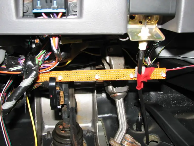

The LEDs were originally 60 degree focus, but they only made a spotlight, so I ground off the tips to make them disperse the light evenly. I mounted the passenger side with some double sided tape, and on the drivers side I used a zip tie and electrical tape (only temporary). As for the board length I bought the biggest one Radio Shack had and then cut them with the Dremel.
Drivers Side
And no the board is not resting on the brake light switch wiring harness

What did you use to grind off the tips, and how did you do it? I bought a pair of what I thought were dykes and was playing around with an old LED, trying to get it flat...but ended up just like shattering it for the most part. When I cut it, it just jaggedly sheered off, which I obviously don't want that, so I need some input on how to do it correctly. BTW, I just got done with my first board!! Woohoo, just need to flatten the lights and mount it, hooray. Haha, man does it look like Frankenstein though, wow.
I used a bench grinder to grind down the tips of the LEDs. Then use clear nail polish to make the lenses clear again.
