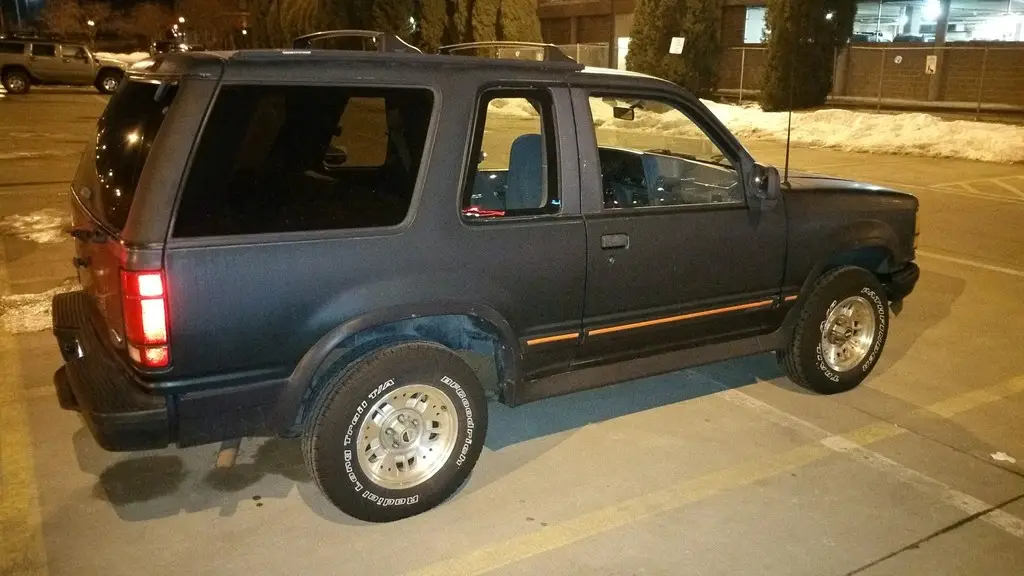

Thanks guys, it's got a lot of little quirks to work out, but the motor and 5-speed seem pretty solid. I'm willing to bet all the shocks and bushings on this thing were installed by the factory. It's quite an adventure going down the interstate with worthless shocks. Lots of play in everything. Not going to fix anything underneath until we decide what we're doing with the suspension, gearing, etc. We've been discussing just going straight to the SAS, but we'll see. I don't have time or a place to do any of it right now, so I think we'll be talking to Stang5lgt about doing it. I saw he was running some pretty darn good deals through Craigslist on SAS and re-gears.

Spent a little time under it today, the clunking in 4x4 is just a bad u-joint on the front driveshaft, I believe the little thud I'm hearing on bumps in the back is actually just a loose body mount and/or I also noticed the hinges on the rear glass are a little loose. Speedo wasn't working so I pulled the cluster, speedo itself works fine, drove down the street with no cluster in watching the speedo cable..........not turning. I think pretty much every bushing on the son of a gun is factory, and therefore roached so prob doing a full bushing kit, depending on the lift decision that needs to be made soon of course. Shocks are more of a decoration on it at this point too, but again.........don't know the lift situation yet damnit. Ran out of time and had to stop there for today. Trying to figure out how to get the climate controls in this thing out for some bulb replacements.

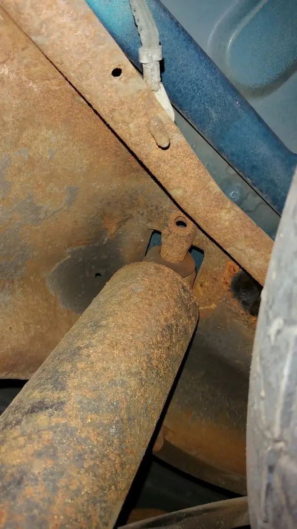

NO BOLTS IN THE TOP OF THE LEFT REAR SHOCK!!! That will make some noise, trust me. Now I know why it had a dip and weave type motion when hitting humps on the highway. LOL. Threw one bolt I could find into it for now. New shocks will be coming with new suspension anyway, so not too worried about it. Also discovered the front noise in 4X4 was not a ujoint but a part of the double cardan joint is broke. I don't have a jack other than the factory one that the truck came with so I could get the driveshaft out yet. Just no room under there right now, need to get this bish in the air!! Hopefully fiddle with it some more today and have more to report on tonight. Have a great Monday everyone!!
