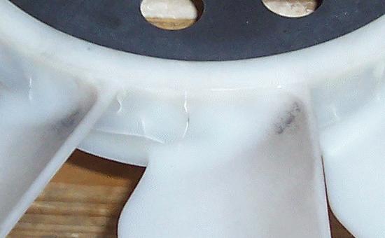

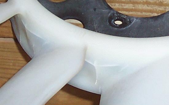

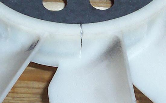

Plastic is a suitable material for numerous automotive components. The photos below illustrate an unsuitable application of plastic. I purchased another used plastic fan in good condition on eBay but eventually want to switch to a metal one. I have the SOHC V6.
Great pics Dale!
