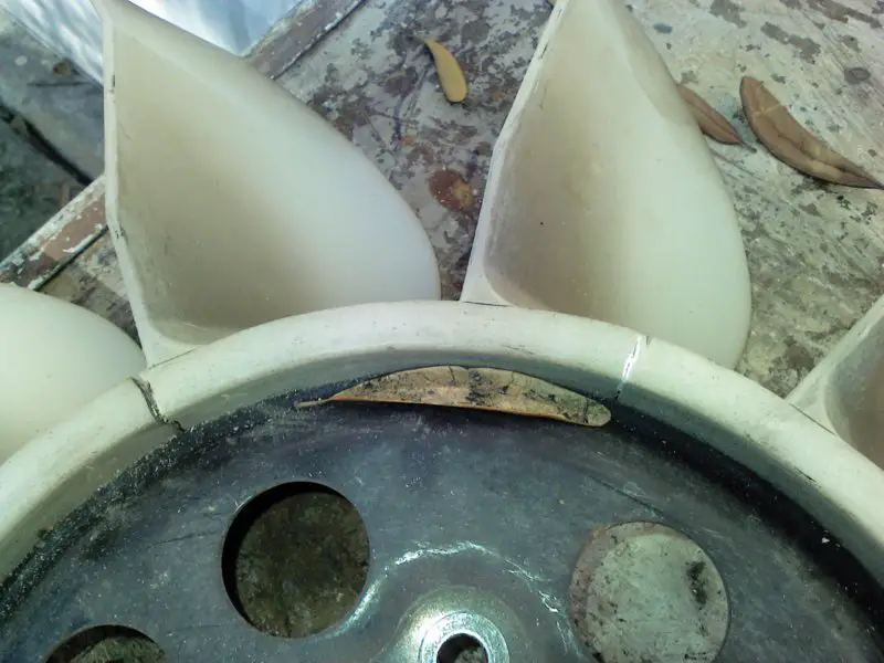

I lost my serpentine belt a couple of days ago and while installing the new one I noticed a clear through crack between the blades and between others I can see white line cracks that haven't separated yet. I was thinking of installing one from the part store for a 96-98 that is metal.
But after reading this I wonder is it even necessary if the plastic ones are all this way?

I just replaced the one on my 2000 5.0L. mine had 1.5" cracks between each fan blade. the best price I found was on RockAuto. the only hard part about replacing it was getting the fan clutch nut loose. don't bother with the cheap loaner tools (even a brand new one didn't work). I found O'Reillys loaner tool to be much stronger and eventually got the job done. I don't care for Dorman stuff. Motorcraft - Cooling Fan Blade - Part # YA228 around $58 w/shipping. fit perfectly. I don't know where you got the YA203 part# from. is that the metal fan?
I figure the plastic fan lasted 14 years and it's not likely the truck will last another 14 years, so plastic is good enough and I don't have to worry about destroying my new radiator anytime soon..

But one question still remains, does one all the way through crack mean I should replace the fan blade?
if only once crack and if it's not all the way to both edges I think you can probably just keep an eye on it for now.

It depends on how badly it's cracked. All of mine have some cracks, but the one on my '00 XLT 5.0 was cracked to the point that it was a scary. After just having replaced the radiator ($130), 2 gallons of antifreeze ($30), the serpentine belt ($32) and the upper/lower rad hoses ($55) it seemed stupid not to replace a $58 fan rather than risking destroying all the new parts I was installing (plus who knows what else might get ruined if it came apart) and getting stranded and having to pay for a tow.

FWIW I actually did have one come apart and take out the radiator right at the connector for the upper radiator hose. That said, every one I've ever seen has had some rather ugly cracks in it so it just isn't realistic to always replace cracked ones.

You are looking for stress fractures between the blades
even new ones out of the box appear to have white stress marks.
