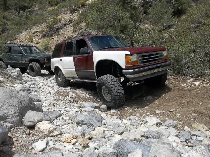

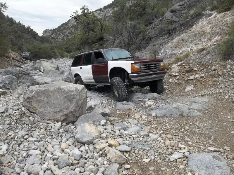

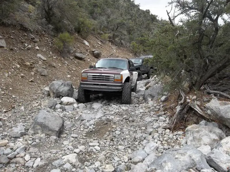

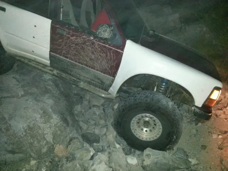

Popped it's cherry this weekend! Did pretty good for it's first time out. I wanted something a little bit on the mellow side trail wise to make sure it's good to go so of course I end up on a trail run with a local club to do what they mostly consider the hardest of all the local trails they ever run and we're gonna do it at night with a pretty gnarly thunderstorm surrounding the canyon we're running! What could be wrong with that for a first time ever on the trail with the 100% freshly built rig? LOL
Escaped damage free though!!! Rock sliders got proven for sure! I will say, the jeeps do have us expos beat in the rocker area between the wheel wells cause we for sure hang low! Only issues I have is in regards to my fiberglass fenders, they need trimmed for sure! I cycled the whole suspension front and rear with tires on checking clearances but in the real world with the weight of the rig involved, I didn't cut enough. No biggie, 15 minutes with the body saw and it'll be ready to rock.
Other then that, everything was a great success!!! I did end up getting winched up one waterfall but 2 out of the 4 jeeps on the trail with me go the line also so it wasn't just me. I had nothing to prove and being fresh and unfamiliar with the true capabilities of my rig I didn't want to push it. Had I been aired down lower I probably would've been fine to be honest.

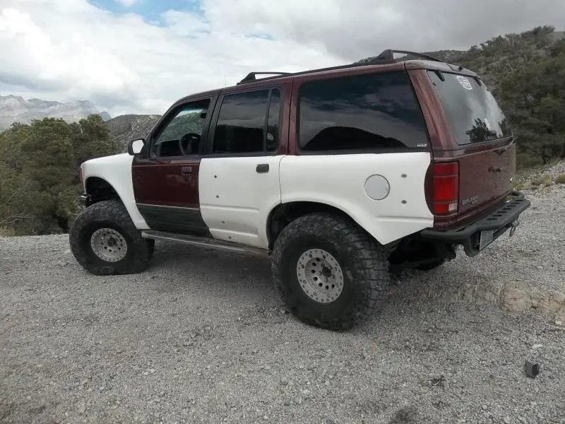

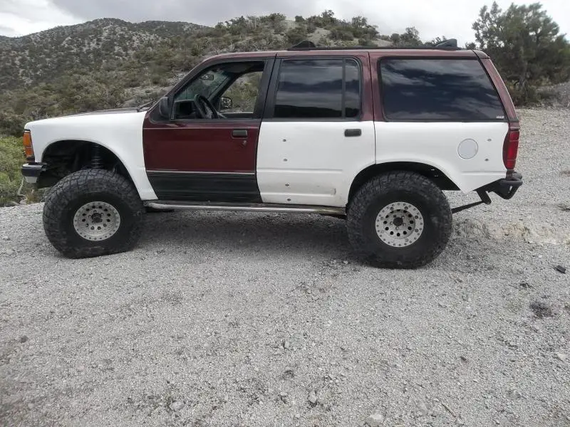

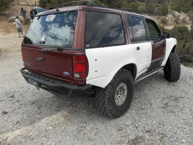

Did you cut out your rockers and put your sliders up as high as you could? I didn't go that far, but the pinch weld is folded and the bars are tucked up as tightly as possible.
Mine are probably similar to yours. I just notched out the pinch weld and folded them over to run my attachment tubes thru each place.
This angle is a bit weird, it looks like there's a big gap on the one closest to the camera but I assure you it's tucked up into the pinch seam like you can see on the next one back.
I plated the frame where the middle two are welded to the frame, the front and rears were a bit interesting with other stuff in the same area so I just went straight to the frame with no plate work.
So far, between my old jeep TJ on 35's and this expo, that's about the biggest disadvantage. Jeeps definitely do have the edge on clearance outside the frame rails. My expo has them beat between the frame rails in ground clearance but they can put their tires over larger rocks without dragging the rockers.
As of right now I'm definitely planning on the Truckhaven trip for sure. The picture up above in post 107 isn't actually even current anymore. I tossed two short stubby little spreader type tubes equally spaced in between for support for mid rail rock hits. I'll be laying a plate across the whole top of them here in the next week or two so they'll double as a step/running board of sorts.
