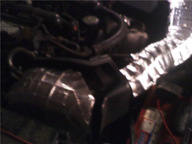

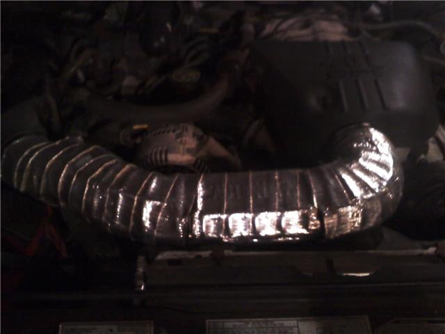

my latest addition to my 91 ex is a completely heat free intake. what i did was remove the hose that comes from the passenger side exhaust that runs into my intake to warm the air when its cold. (which never works and heats the air anyways.) i then proceeded to put 2000 degree heat wrap from autozone all the way around my intake. the pipe to the air box, the air box, and the pipe form the airbox. my air intake temp 3" in front of the throtle body went from 200 down to 110. after that i also took a flex hose and ran it from the hose that runs into the air box out to the front of the grill, i now have ram air, and it works great on the highway, and you get whatever the air temp is outside into your motor. on the high way i get about 3 mpg better now, and the engine runs cooler out here in hell arizona. i love this mod so much i would like everyone else to know about it. click the links below for pics

here they are

Looks good. Excellent idea, don't know why anyone hasn't posted an idea like this before. :salute: I think I may do this see if I can get some better fuel economy on my 98 and/or my 05. My 98's fuel economy all of a sudden went from 19mpg to like 13 mpg.
Thanks for fixing the pics. :thumbsup:
ya the next thing i am doing is insulating my ac system. just whatever you do, DO NOT heat wrap your headers, it will cause the cylinders to retain and either the head will crack or your car will over head, so just insulate everything else.

IAT determination?
. . . my air intake temp 3" in front of the throtle body went from 200 down to 110. . .
How did you determine the temperatures? Was it when the vehicle was moving or sitting still?
Using a scanner and data logging my IAT on my 2000 Sport I found that if I drive over 35 mph for 70 seconds the IAT drops to about 3 degrees above the outside air temperature. However, when stopped the IAT would increase to 100 degrees in 75 seconds when the outside air temperature was only 74 degrees.
ya see out here it is 115 in the summer. i have a temp probe that i put in side the intake 3" in front or the tb. i did this moving at 45mph. also when you guys remove the hose from the exhaust heater to the air box you will need to cap that hole off or it will still pull hot air. i used a spray paint can top and some tape it works great
Pretty good idea, but I don't know if the insulation is really doing that much at highway speeds. The plastic intake tube doesn't affect the air temp as much as say, a metal one would. The intake manifold itself would also heat up the air quite fast once it gets there anyway, and is in a prime spot (right on top of the engine) to get as hot as possible.
I'm not knocking it, though, since it's been proven before that the small things do add up, and if it seems to give you some improvement, great.
You're also right about not wrapping headers or exhaust parts, BUT some spray-on ceramic coating is just the thing.
