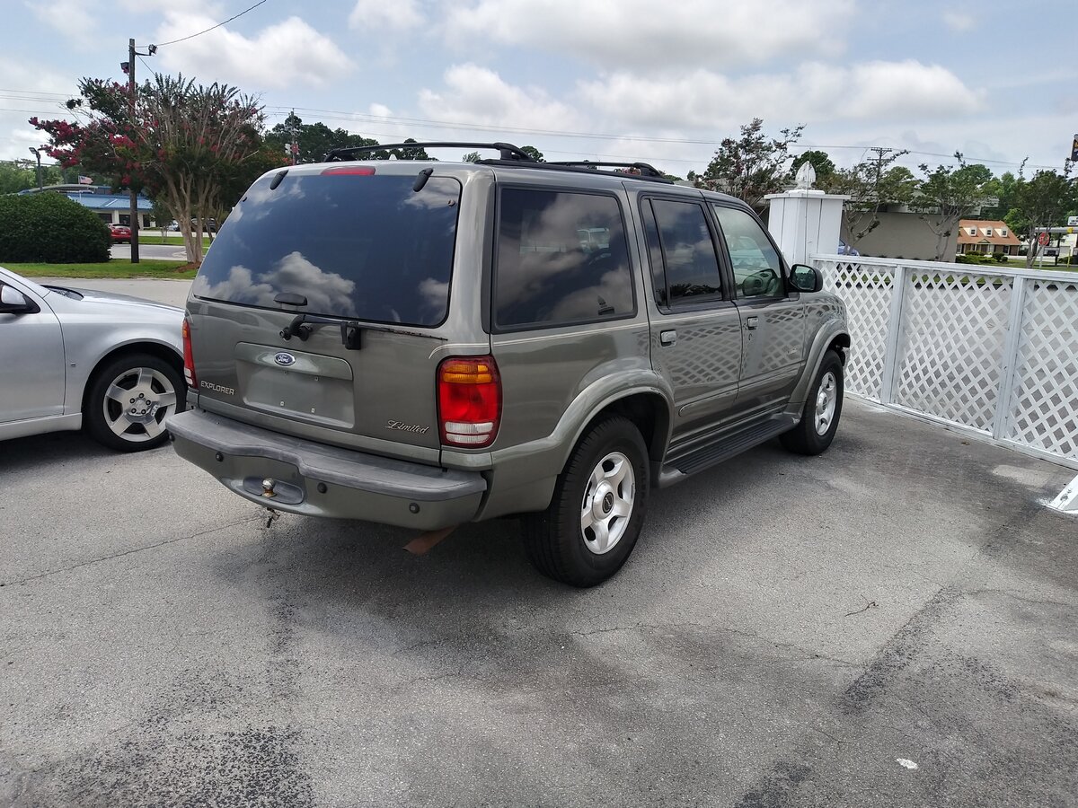

@Zackie I have a '99 2-door and a '00 4-door, can confirm that the rear hatch is the same, but note that some trim pieces may differ between the two, for visual purposes.
As I recall, the 95-98 hatch and bumper do bolt up to the 99-01 body, and vice versa, but be warned that the rear contours are not the same (early is flat, late is curved) as well as the early bumper having the license plate mount, whereas the late hatch has the license plate mount.
Observe the bottom trim piece on the Limited, absent from the Sport.
To help, notice that the small ridge on the side continues behind the rear wheel well and across the hatch on the Sport, but is covered by trim pieces on the Limited. I believe Eddie Bauer and Limited shared the same fender flares and body trim. Hope this helps!
My '99 XLT actually had a trim like that at the bottom of the hatch originally, the hatch I had to swap it for didnt though, but that doesn't make a fitment issue or anything. As said, can always use the older hatch, just have to swap the taillights and bumper as well as the hatch, then have to rewire the license plate lights to the bumper rather than the hatch, as stated works vice versa.
